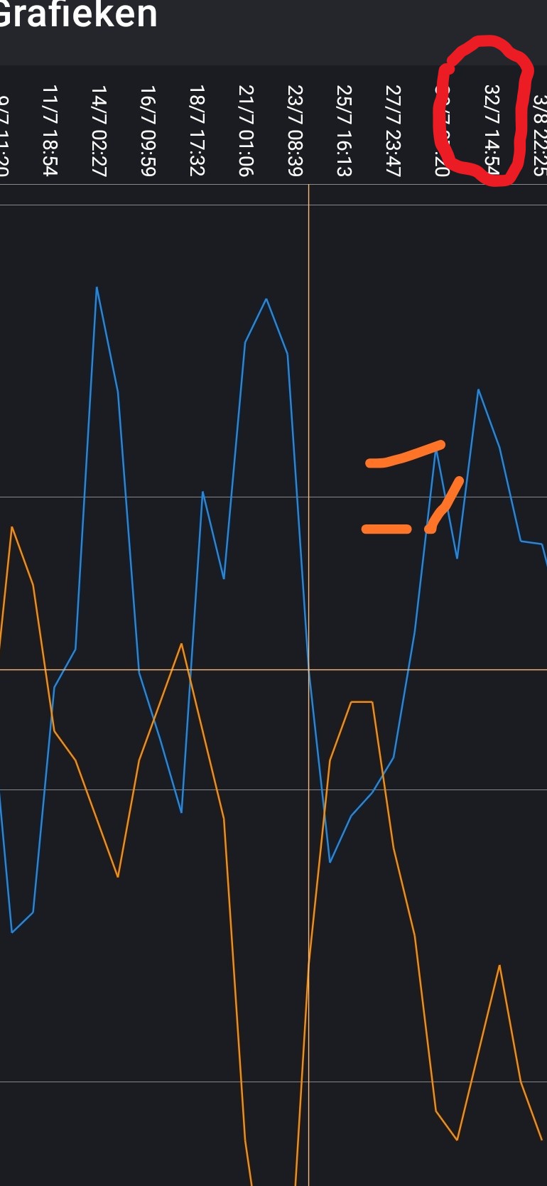

New date 32/7 :-)
The app displays a date that to my knowledge doesn't exist.
- IMG_20200804_074204.jpg (112.87 KiB) Viewed 2501 times

Re: New date 32/7 :-)
Oef thats weird.. ok ill put it on my list to check, thanksniki_lauda wrote: Tuesday 04 August 2020 7:51 The app displays a date that to my knowledge doesn't exist.
