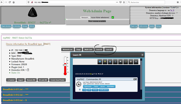

# 1.6.0 : 29/08/2020
# learn IR/RF from Web Admin Page

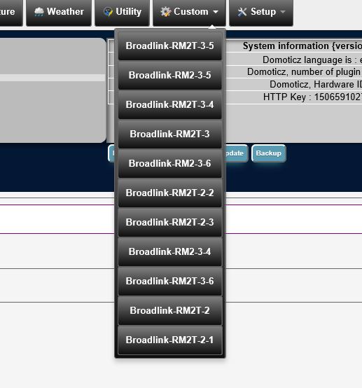

Hi Zac45, I just updated your plugin via the web page and it's created a whole bunch of extra pages! I have 2 devices, but now I have 8 pages!!
Also, the 2 correct pages don't load when you click on them, you need to click on it, then refresh the page.
Cheers!

yep, that's the one way I had found to be able to have the Domoticz device appear in html popup.maninblack30 wrote: Sunday 30 August 2020 12:34 Hi Zac45, I just updated your plugin via the web page and it's created a whole bunch of extra pages! I have 2 devices, but now I have 8 pages!!

I have got three devices RM3 mini. The plugin has detected all and now I have six new pages but always shows me the same device
I tried with three browsers and clean cache bud didn't work

Hi,runy wrote: Tuesday 08 September 2020 16:59
show me content of : \Domoticz\www\templates

I have updated the plugin but I have the same error, three webpages but the only one device. My template folder is:zak45 wrote: Tuesday 08 September 2020 19:37have seen a problem into the code, just update your plugin.
Broadlink-RM24M-16.html Broadlink-RM2M-15-126.html custom.example
Broadlink-RM24M-17.html Broadlink-RM2M-15-133.html readme.txt
Broadlink-RM2M-15-125.html Broadlink-RM2M-15.html
how to I can see the version of the plugin?

You can delete all Broadlink-*.html files and restart Domoticz

Ok, it's working!!! I have deleted all Broadlink devices and create again and now it's workig.
just for your information, two Rm3 mini are new and only use the Broadlink app to connect them to my network, but I have another RM3 mini older (three years maybe) and for this I need to complete the process in the Broadlinkg app to work fine.
