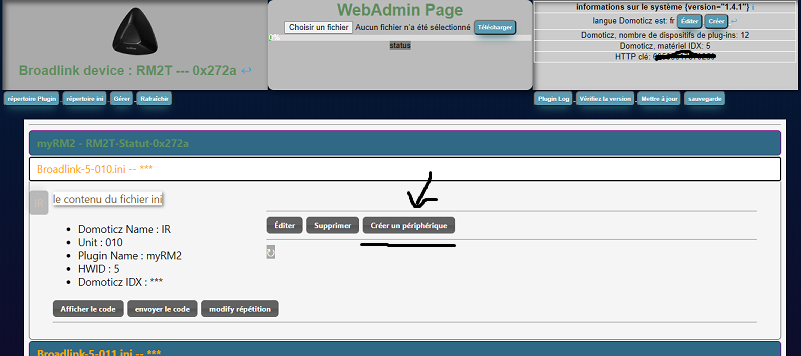

zak45
Posts: 954
Domoticz version: V2024.4
Re: Python Plugin : Broadlink
Post by zak45 »
DrMacabre wrote: Friday 21 August 2020 7:54 Alright, i select the ini file by clicking « ini directory » i suppose and then there should be a create device button ? (which i don’t see on my ipad if I’m in the right place)
Nope..."ini directory" button browse only.
You need to go to manage and click on the ini file :

DrMacabre
Posts: 74
Joined: Monday 26 December 2016 16:30
Domoticz version: 4.11590
Location: France
Post by DrMacabre »
zak45 wrote: Friday 21 August 2020 11:58
Got it, thank you :)
