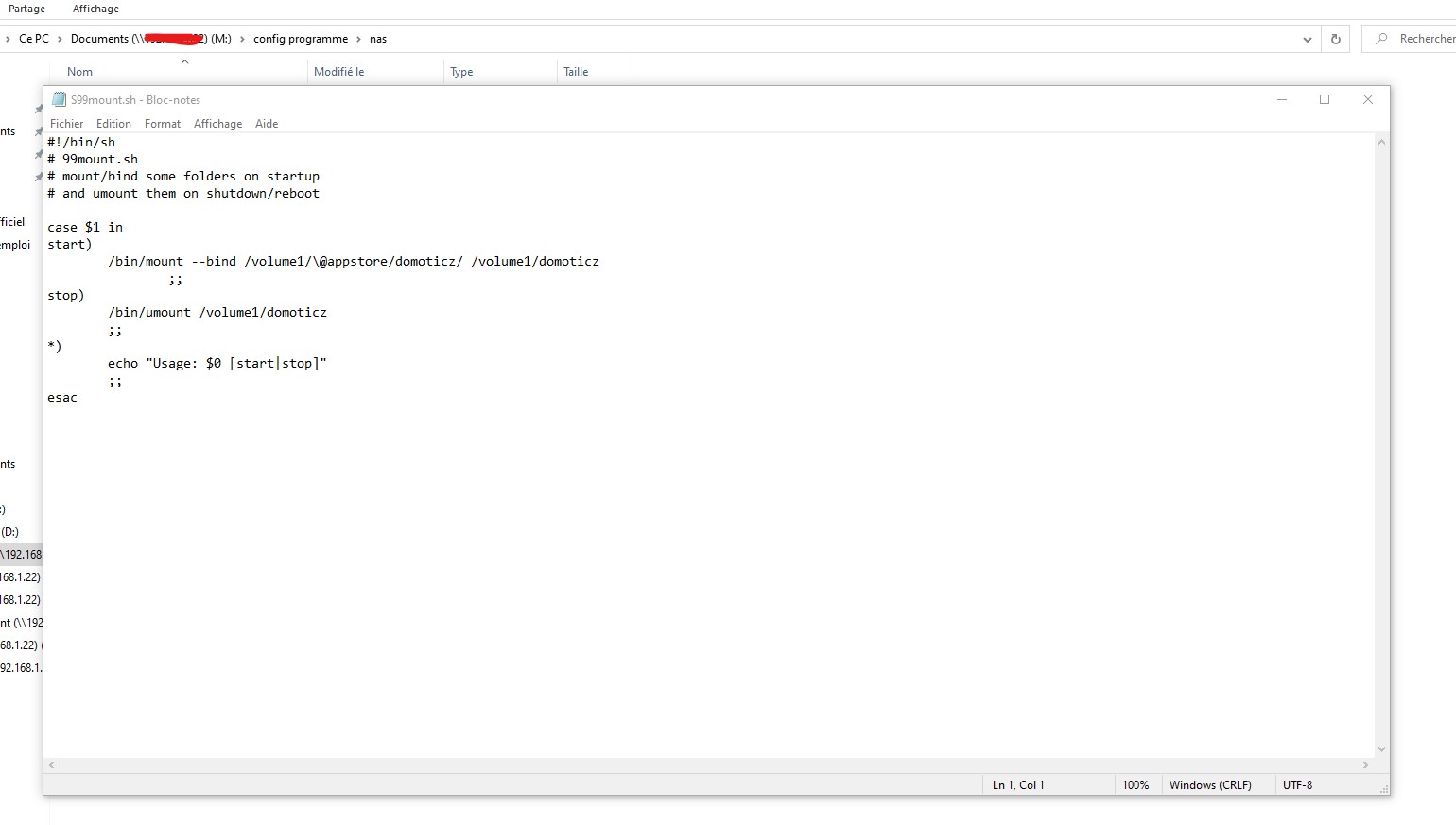

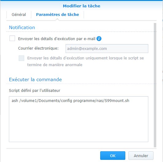

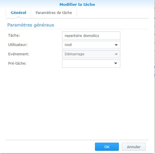

Good morning all
on my nas ds115j, I installed domoticz
https://www.domoticz.com/wiki/Synology_ ... ion_folder
thanks to this page I managed to have access to the domoticz folder
but when restarting my nas, I lose the configuration
according to the tutorial on this page, I put the script in a folder
but I do not succeed, I nevertheless put the script in a scheduled task "start)
you would have a tip, because I think I misinterpreted the last part, not having much knowledge in scripts
