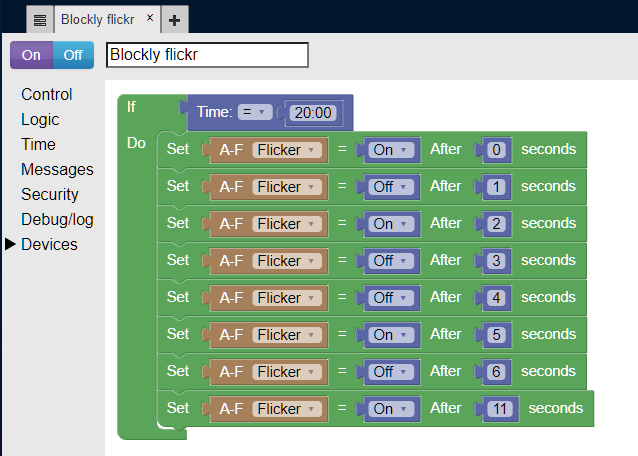

Re: Very basic off/on with timer
tontze wrote: Friday 28 August 2020 21:59 certain time of day, like 20:00, switch is on, then it switches off and on 6 times in 1 sec interval, and stays on.
dzVents version
return
	on =
		timer =
			'at 20:00',
	execute = function(dz)
	    light = dz.devices('Flicker')
	    for i = 0, 12, 2 do
	        light.switchOff().afterSec(i)
	        light.switchOn().afterSec(i + 1)
Classic Lua version (save with trigger type timer)
local executionTime = '20:00'
local light = 'Flicker' -- Name of your light
if os.date('%H:%M') == executionTime then
     for i = 0, 12, 2 do
        commandArray[#commandArray + 1] = { [light] = 'Off AFTER ' .. i }
        commandArray[#commandArray + 1] = { [light] = 'On AFTER ' .. (i + 1) }
return commandArray
Blockly (save with trigger type timer)
