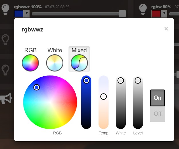

Dashticz 3.5.2 beta is a small update containing the following changes:
Enhancements
  • New colorpicker for RGB devices, including support for whites. See :ref:`colorpicker`
Fixes
  • Fix for Omrin garbage provider
  • Fix for Venlo garbage provider
With the new RGB colorpicker you can switch between white modus and RGB modus and select the white color temperature for RGB dimmers that support this.
In the current implementation the Domoticz behavior is reproduced. Configuration of the colorpicker currently is limited: Let me know which functionality you like to be added.
You can select the colorpicker with the following block parameter per device:
colorpicker:0, to show a block without colorpicker
colorpicker:1, to use the old colorpicker
colorpicker:2, to use the new colorpicker
By adding the following parameter to CONFIG.js you set the new colorpicker as default for all devices:
config['colorpicker'] =2
For documentation see:
https://dashticz.readthedocs.io/en/beta ... notes.html

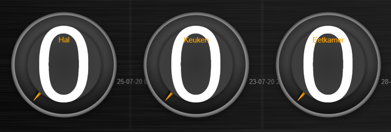

I have an issue with the dials. Since the latest update the font is a lot bigger.
Any suggestions to solve that?

Brinkie wrote: Tuesday 28 July 2020 10:25 I have an issue with the dials. Since the latest update the font is a lot bigger.
Try this is your custom.css
.graphbuttons {
display: none;
font-size:10px;
Brinkie
Posts: 9
Joined: Wednesday 29 April 2020 17:08
Domoticz version: 2020.1
Re: Dashticz 3.5.2 Beta
Post by Brinkie »
Thanks for your reply madpatrick!
It didn't work for the dials (switches), but works only for the buttons in the graphs.
Brinkie
Posts: 9
Post by Brinkie »
After a complete reboot of the NAS, the dials are back to normal. :shock:
Is this still an issue? If so, please post you block from CONFIG.js. Also, please let me know which beta you are on, and check if there is any custom.css that may be interferring.
