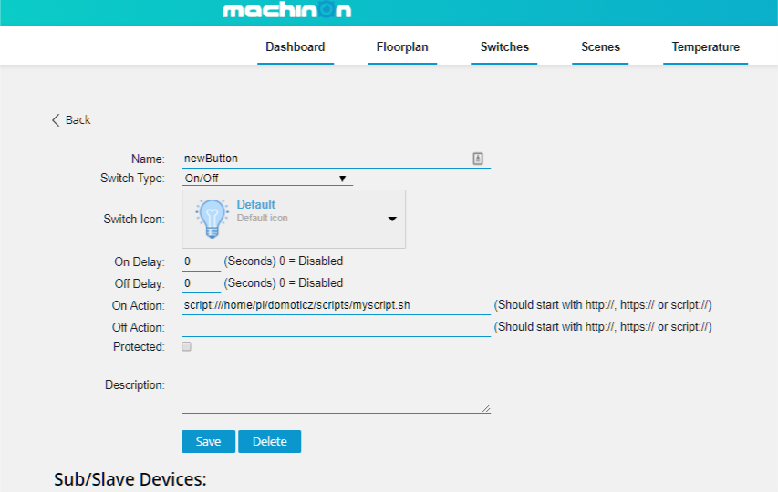

script (make sure it can be executed by domoticz (chmod 755) :
#!/bin/bash
echo "Today is $(date)" > /dev/null 2>&1
myvar=$(date)                 # get date string in var
myvar="${myvar// /%20}"       # prepare for curl (replace spaces with %20)
curl  "http://192.168.1.45:8082/json.htm?type=command&param=udevice&idx=34&svalue=$myvar"
create a dummy switch and put in the on section: script:///home/pi/domoticz/scripts/myscript.sh
Make sure to use 3 ///
on Action.png (58.66 KiB) Viewed 1332 times

But still one question : will the result of the script be displayed if I use a switch as device?
If so, where would it be supposed to be displayed?
(that's why I fisrt tried to use "text" device type)
Thanks again for your help, much appreciated! ;)
Re: Display the result of a script into the Dashboard
julien92 wrote: Saturday 19 January 2019 0:00 Thanks a lot Waaren :)
No the switch is only used here to have a method to trigger the bash script. The bash script will send the text (here date) to a text device.
