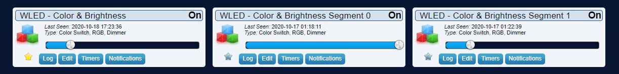

I'm still working things out. But as soon as you have more than 1 segment you will get a master color and brigtness slider (the one that you already have) and 1 color and brightness slider per extra segment. I think it is the same way Home Assistant does it.
I still have to look into effects, presets and palletes.
Let me know your ideas.

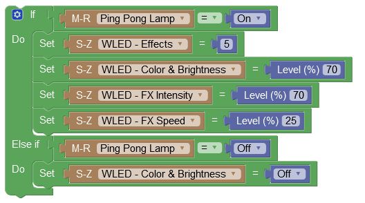

Does anyone know why this doesn't work
The lamp switches on and off ok and all set percentages get written ok but it completely ignores the Set WLED - Effects value so I can't have a preset pattern at power on, I've tried altering the Set order and delaying it but it makes no difference, also tried the value in a txt box with the pattern no. and name but no response, changing the pattern in Domoticz directly on the switch page works fine.
Any ideas guys.
TIA
Dave
Any ideas guys.
TIA
Dave

WLED - Effects is also a level setting. In this case 50%.Dave21w wrote: Monday 07 December 2020 22:06 Does anyone know why this doesn't work
Any ideas guys.
TIA
Dave
It seems a bit strange but that is how Domoticz selects work.

Ah OK, but then this means I can't go above pattern 100 (%)

I think you actually can go higher as it's not really a percentage.Dave21w wrote: Monday 07 December 2020 22:32 Ah OK, but then this means I can't go above pattern 100 (%)
