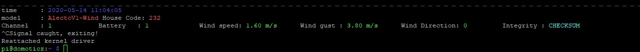

could this be a bug? I see the same with AlectoV1-Wind
Annotation 2020-05-14 110435.jpg (15.4 KiB) Viewed 5921 times
Annotation 2020-05-14.jpg (25.99 KiB) Viewed 5921 times
direction is shown and updated but no wind speeds.
I'm running 2020.2 btw
