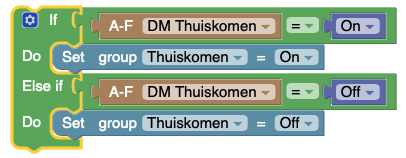

To let this work I have one dzVents script and one Blockley.
the first script is an toggle script to switch on and off an dummy switch
The second is an blocky that when de dummy switch is on the group wil go on.
It would be nice to get one script that can switch on and off an group.
I tried something, but it won't work.
see the script en blocky below.

Re: make one script from two scripts
PatrickDV wrote: Sunday 05 July 2020 21:27 It would be nice to get one script that can switch on and off an group.
can you try this?
return
    on =
        devices = { 3722, 3736 },
    execute = function(dz, item)
        if item.active then
            thuiskomDevice = dz.devices('DM Thuiskomen')
            thuiskomGroup = dz.groups('Thuiskomen')
            if thuiskomDevice.state == 'On' then
                thuiskomGroup.switchOff()
                thuiskomGroup.switchOn()
            thuiskomDevice.toggleSwitch()

Re: make one script from two scripts  [Solved]
Post by PatrickDV »
Hello Waaren,
it is working, I changed it a little bit so I can remove the dummy switch DM Thuiskomen
Thanks for the help!
return
    on =
        if item.active then
            if thuiskomGroup.state == 'On' then
            thuiskomGroup.toggleSwitch()
