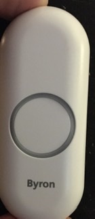

How to ad the byron doorbell?
I have the byron protocol on and also ac arc x10 ligtning4 , but its not regonized by Domoticz
How to add it?

In order to get some advice's and/or support, I think you should submit more information.
Which Domoticz version?
Which software version in your RFXCom device (which device)?
Does you RFXCom device recognize your Doorbell?
Which type of Doorbell. Byron produces more than 1 type, and you can not expect that forum members are sorting that out, based on a picture of the push button. So,there exist no "the byron doorbell".
