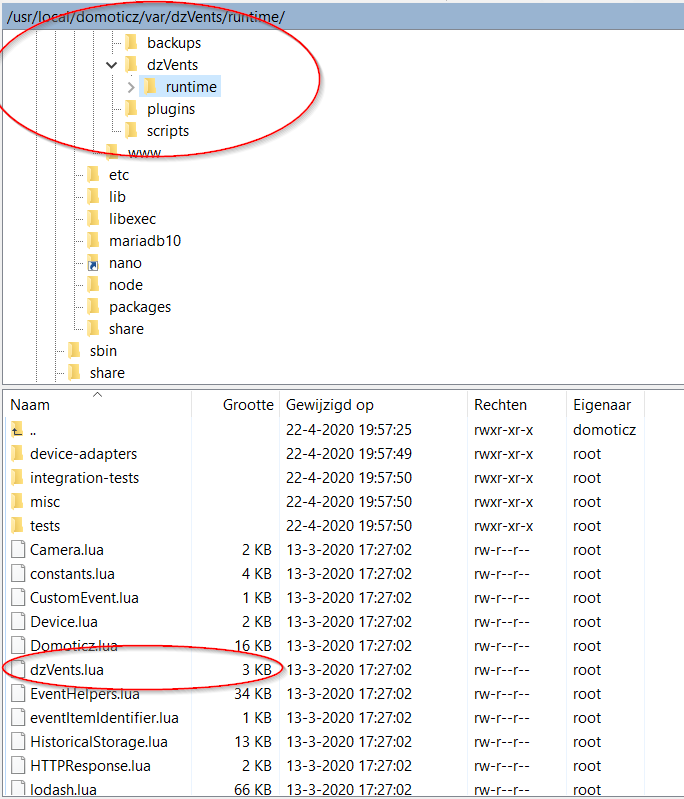

i see that you are doing things manually(and that is probably the problem)
on my setup
/usr/local/domoticz/var/dzVents/runtime/dzVents.lua
and scripts go in
/usr/local/domoticz/var/scripts/dzVents
please note that scripts made in domotics are automatically placed in
/usr/local/domoticz/var/scripts/dzVents/generated_scripts
so not need to put them there manually

Hi Gravityz,
since in my package version (Domoticz version: 3.9483-7) on my DS112 NO dzVentz available was, I copied the files from the Apollocake version, and placed them directly as suggested https://www.domoticz.com/forum/viewtopi ... 42#p184442 .
so now it can find the dzVents.lua file, and I've checked the directory tree, everything looks like your codelines.
when i make a fake testscript, in dzVents, it actulally is placed in de generated directory :-)

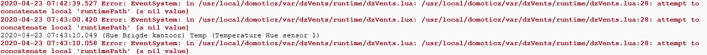

i still get errors:
2020-04-23 07_43_36-Microsoft Edge.png (22.54 KiB) Viewed 2663 times
so... are there any suggestions what to do?

@remcootje.
i looked in my dzvents.lua file and see this(i also have appollolake so the files should be the same)
looks like runtime_path is empty.(this path is probably set during the install of the package which you skipped)
did you try a test and modify this path to see what happens(not a fix but then we know if this is the problem)
local runtimePath = globalvariables['runtime_path'] -- should be ${szStartupFolder}/dzVents/runtime/
to
local runtimePath = '/usr/local/domoticz/var/dzVents/runtime/' -- should be ${szStartupFolder}/dzVents/runtime/
if this works maybe also change the scriptpath.
when things are working you have time to look for the real solution.
@Jumbotroll probably knows exactly where things go wrong but i suspect he is occupied with more important mathers(these are strange times for everybody)
