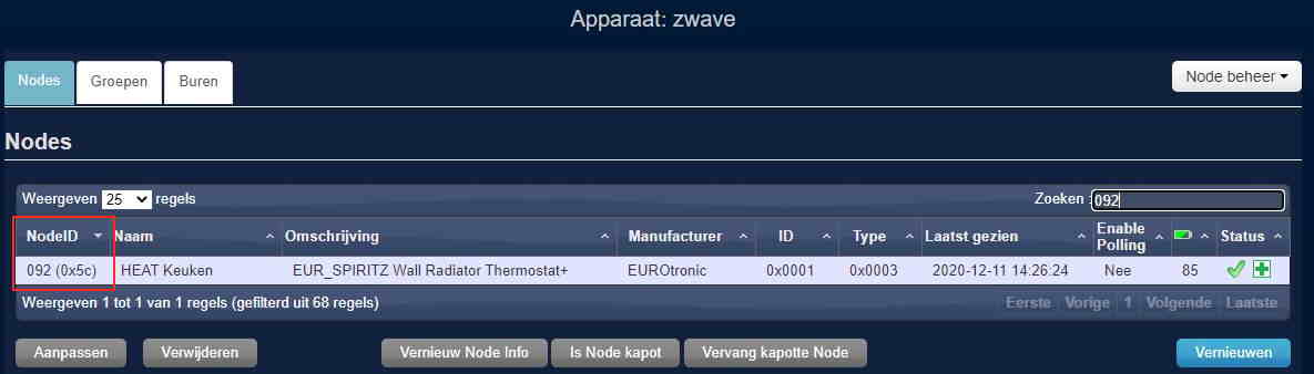

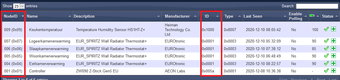

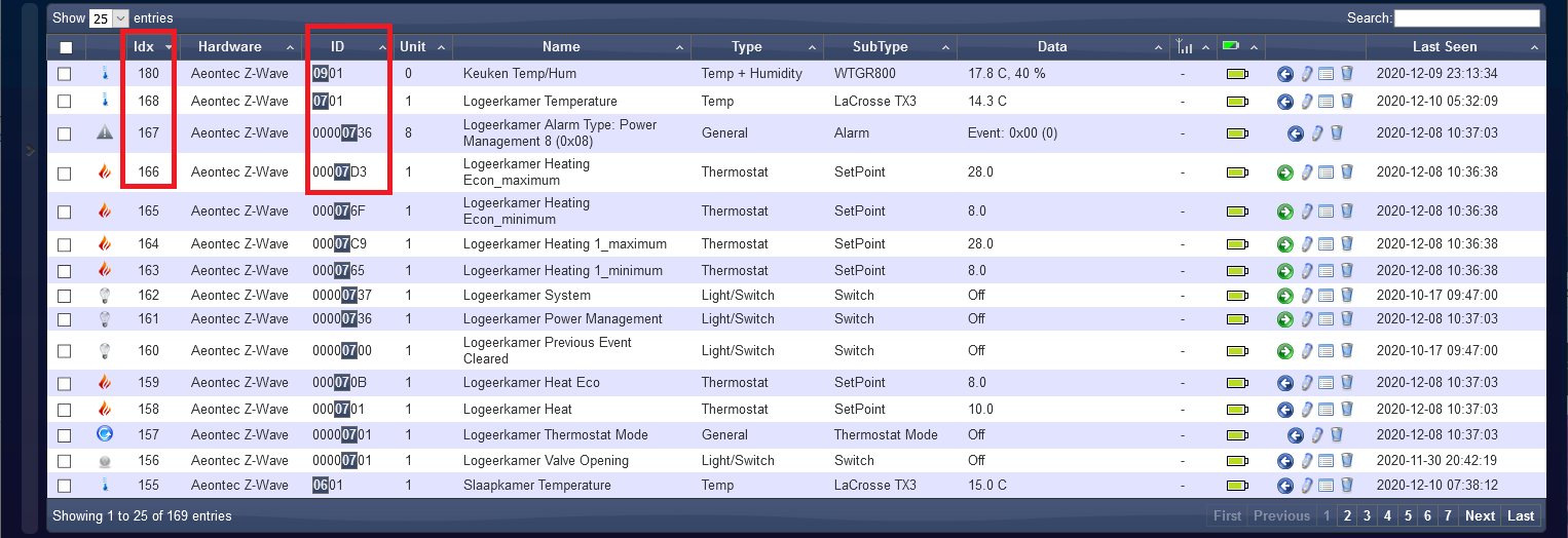

"and then put 92 (my valve's id) in that group 2"
That valve ID 92, is it de Domoticz valve's z-wave Node-ID, z-wave ID, device Idx or device ID (see highlighted items in the images)
Could you share a screenshot how the zwave setup looks like (especially where you can see this 1,92) ? That would be very helpfull

The ids I'm referring to are the z-wave ids. So that is the NodeID column in your 2nd picture. Associations are a z-wave specific feature, so you can only specify z-wave node-id's here and even then, you can only use any features your specific z-wave devices support.

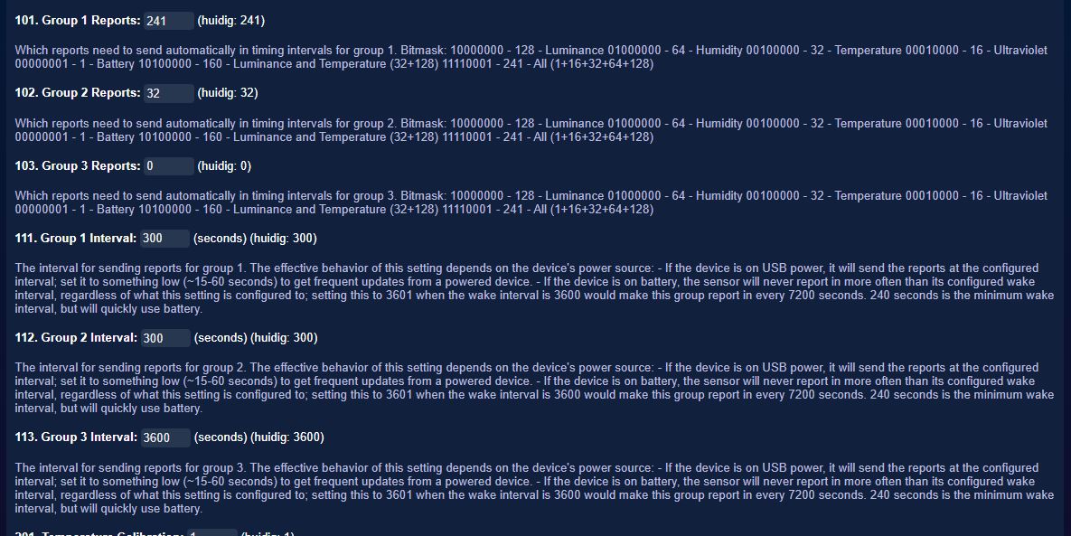

Capture 43 Options 101 - 113.JPG (159.81 KiB) Viewed 3797 times

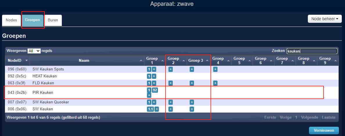

However, only 1 -the lifeline group- is shown in Domoticz:
Capture 92 associations.JPG (39.1 KiB) Viewed 3797 times
I was expecting to see a '+'-sign under 'groep 2' and 'groep 3' as well, but they are not there. I wanted to put the node id 92 (the node id for my spiritz device) in this 'Groep 2', to have node 43 send the temperature to my spiritz every 5 minutes. But because there is no such 'Groep 2' for the multisensor, I have tried to put it in the lifeline group instead.
I can save you some time however: This setup doesn't work. I have since then read that this is a problem of the spiritz firmware: it apparently accepts, but doesn't understand the temperature message the multisensor is sending. This has something to do with the way the temperature value is encapsulated in some multi-value message format. I don't know all the details either, but apparently only a very limited number of z-wave temperature devices can actually be used as an external sensor for the spiritz because of this, and my ZW100 multisensor 6 isn't one of them. Eurotronic doesn't mention this anywhere. But then, they don't really advertise the external sensor feature either. I think this is a shame as it would make their valve so much more useable....

1 - the aeonlabs ZW100 multisensor 6, allows only 1 association group to be set in the groups tab, even if you set option 102 and 103.
2 - the eurotronic spirit zwave has a firmware that doesn't properly support temperature notification coming from anything but the simplest temperature devices.
