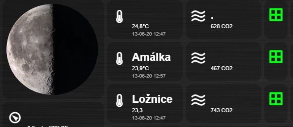

i really try how to fix empty titles, but can anyone help me? :-)
I´m using:
blocks[511] = { title: '',last_update: false
or
blocks['384_2'] = {}
blocks['384_2']['width'] = 2
blocks['384_2']['title'] = ''
blocks['384_2']['last_update'] = false
and from 3,5 master I get the following block:
Poznámka 2020-06-13 125759.jpg (30.23 KiB) Viewed 902 times

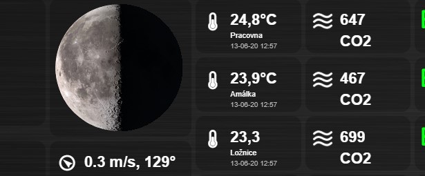

as an old one was:
Poznámka 2020-06-13 125837.jpg (33.35 KiB) Viewed 902 times
Any Idea how delete, or not use a title and get a value bigger?

You can switch the title and value by adding the switch. See below
blocks['384_2']['switch'] = true

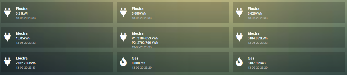

What is the file where Dashticz makes it initial dashboard with devices from my Domoticz?
Why have a number of blocks the same name? See picture below? Can not find this in the doc.
Greetings McMelloW

The file 'custom/CONFIG.js' contains the Dashticz configuration. If not screens/columns have been defined in CONFIG.js then Dashticz will show all you Domoticz devices that are marked as Favorite.
The devices you see are the subdevices of a P1 smart meter. In general, if a Domoticz device contains several data items, like a P1 Smart Meter, or a TemperatureHumidityBarometer device, for each data element a block will be created.
If you only want to show a specific subdevice, for instance subindex 2 of device 34, then use the following key in CONFIG.js: '34_2'
For a temphumbar device it's possible to combine the data into a single block by setting the block parameter 'single_block' to true. (not yet documented ...)
