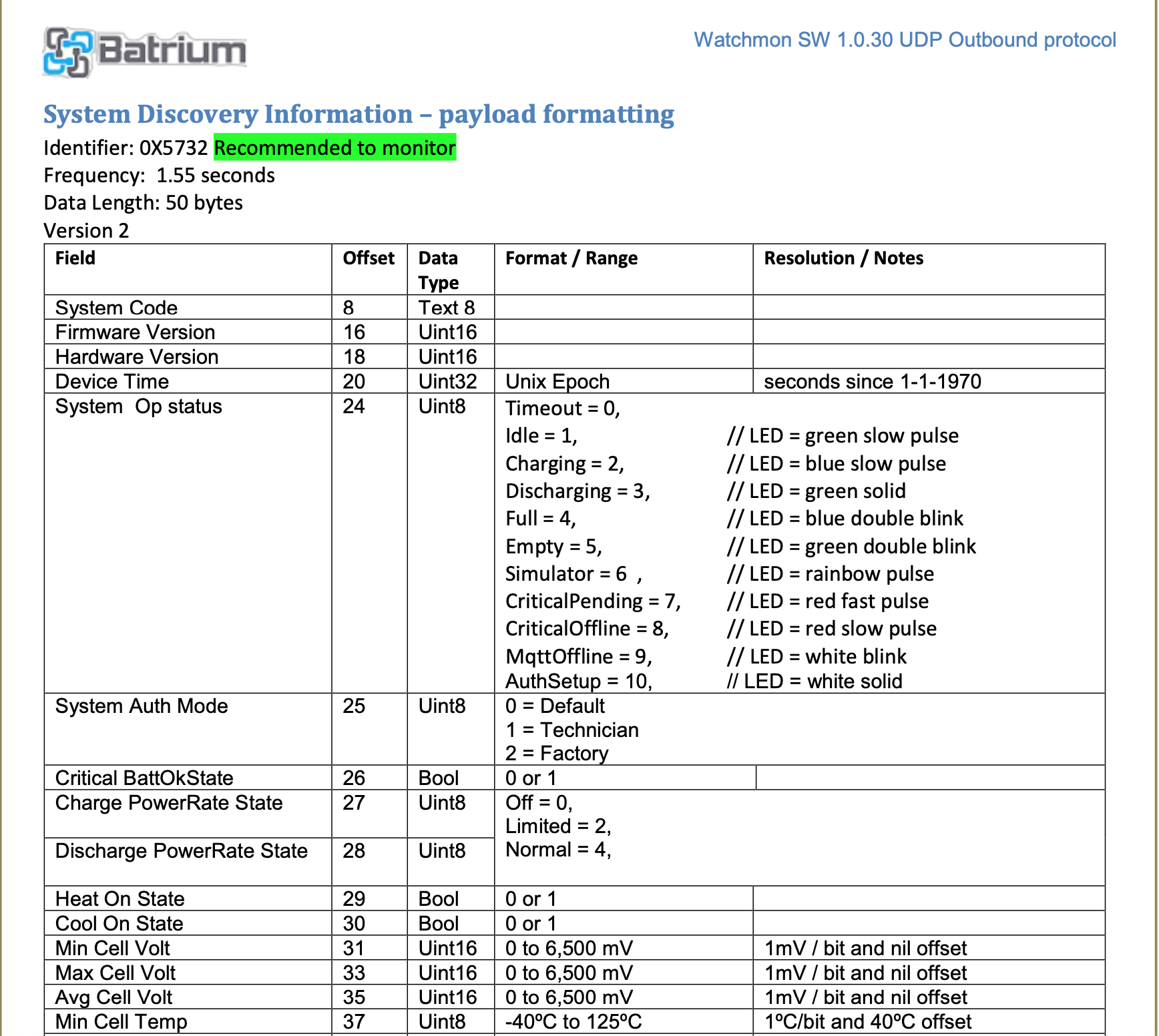

Hi, is it possible to read-out a Battery Management System with a UDP Outbound protocol in Domoticz
If yes, how to do it?

HI,
@Knibor
I think, that it is possible, as I see in System Op status MqttOffline =9.
This means that this unit may have MQTT available.
In that case with a MQTT server, such as Mosquitto and Node Red, it will not be too difficult.
Can you sort out the MQTT part?
[Added] I'm pretty sure . See:
https://github.com/Batrium/WatchMonUdpListener

Hi FireWizard,
Thanks for the response
I'm not familiar with the MQQT. But if I'm right, WatchMon UDP Binary Listener translates to JSON and stores to influxdb or sends it to MQTT . So I need a separate server, e.g. Rasp Pi, which I connect to the wifi from Batrium BMS on which WatchMon UDP Binary Listener runs.
And from Domoticz I connect to the Rasp Pi server MQQT. Doesn't Domoticz have a UDP listerner plugin that can do this? Then it is probably possible to communicate directly with the Batrium from Domticz.
