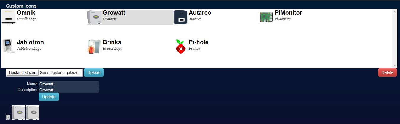

Had the same issue.
- Stopped the plugin
- Removed the Growatt icon (select the icons press red delete button).
- Restarted the plugin.

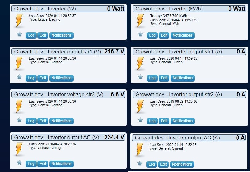

Currently building on expanding the Current Plugin. So much interesting info to find.

How can I get this additional parameters?:
sincze wrote: Tuesday 14 April 2020 21:05 Currently building on expanding the Current Plugin. So much interesting info to find.
sincze
Posts: 1302
Domoticz version: 2024.4
Re: Python Plugin: Growatt Inverter
Post by sincze »
Obtained by calling an additional URL from the Growatt interface.
However after specific time the cookie expires and the data is not updated anymore so that is a big miss.
Seems to be unable for me to fix it at the moment.
