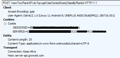

The following is shown in the Domoticz log, for authentication I need:
Set-Cookie: JSESSIONID=*****
Set-Cookie: SERVERID=************

If I use a function like the following I am only able to see/extract the JSESSIONID, what do I miss.

Post via Fiddler:
POST http://server-api.growatt.com/newTwoPlantAPI.do?op=getUserCenterEnertyDataByPlantid HTTP/1.1
Cookie: JSESSIONID=**********************************; SERVERID=*******************|************|***************
Content-Type: application/x-www-form-urlencoded;charset=UTF-8
Content-Length: 25
User-Agent: Domoticz/1.0
Host: server-api.growatt.com
Connection: Keep-Alive
Accept-Encoding: gzip
plantId=UUUUUU&language=1
Post via Python Plugin
2019-08-19 21:39:35.372 (Growatt No Basic Auth) Cookie Available StationDataRequest: {'Verb': 'POST', 'URL': '/newTwoPlantAPI.do?op=getUserCenterEnertyDataByPlantid', 'language': 1, 'plantId': 'UUUUUU', 'Headers': {'Content-Type': 'application/x-www-form-urlencoded; charset=utf-8', 'User-Agent': 'Domoticz/1.0', 'Accept-Encoding': 'gzip', 'Host': 'server-api.growatt.com', 'Connection': 'keep-alive'}, 'Cookie': 'JSESSIONID=**********************************; SERVERID=*******************|************|***************'}
mmmm... what did I miss.

So "DumpHTTPResponseToLog(self.apiRequestHeaders_withcookie())"
Gives me the following, however no usefull data JSON from the server. :(
But at least we are moving forward. :D
2019-08-21 20:40:06.521 (Growatt) HTTP Details (4):
2019-08-21 20:40:06.521 (Growatt) >'Verb':'POST'
2019-08-21 20:40:06.521 (Growatt) >'Headers':
2019-08-21 20:40:06.521 (Growatt) ---->'Host':'server-api.growatt.com'
2019-08-21 20:40:06.521 (Growatt) ---->'Accept-Encoding':'gzip'
2019-08-21 20:40:06.521 (Growatt) ---->'Connection':'keep-alive'
2019-08-21 20:40:06.521 (Growatt) ---->'User-Agent':'Domoticz/1.0'
2019-08-21 20:40:06.521 (Growatt) ---->'Cookie':
2019-08-21 20:40:06.521 (Growatt) --------['JSESSIONID=******']
2019-08-21 20:40:06.521 (Growatt) --------['SERVERID=******']
2019-08-21 20:40:06.521 (Growatt) ---->'Content-Type':'application/x-www-form-urlencoded; charset=utf-8'
2019-08-21 20:40:06.521 (Growatt) >'Data':'plantId=******&language=1'
2019-08-21 20:40:06.521 (Growatt) >'URL':'/newTwoPlantAPI.do?op=getUserCenterEnertyDataByPlantid'
2019-08-21 20:40:06.522 (Growatt) Good Response received from Growatt, Dropping connection.
