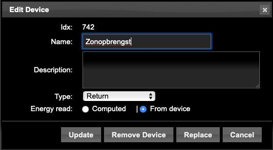

The target device (731) must be set to receive the energy read from device (like below picture)

the virtual device is configured as follows:
Schermafbeelding 2020-06-04 om 13.45.39.png (28.66 KiB) Viewed 1930 times
