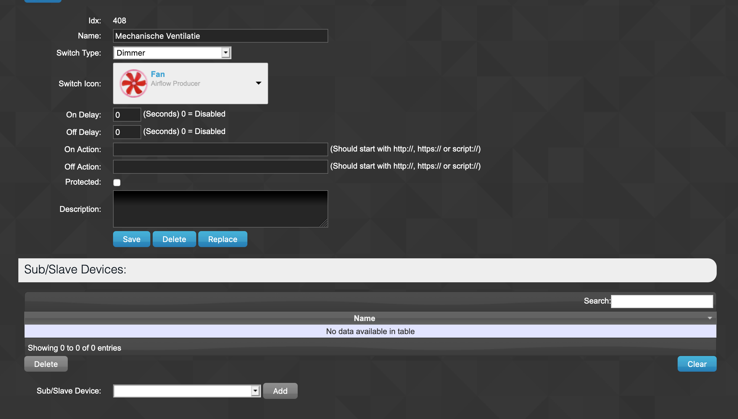

I assume based on this that the device is not set at level 50 ?
Can you show a printscreen of the levels of the device?
What is the type / subtype (as seen on the device tab?
RvdM
Posts: 39
Joined: Friday 10 July 2015 21:06
Domoticz version: 2020.2 1
Location: Deventer, NL
Re: Why does this dzVents script not work
Post by RvdM »
See attached, and no its not set to 50
Schermafbeelding 2020-06-01 om 22.52.38.png (140.41 KiB) Viewed 2417 times
Schermafbeelding 2020-06-01 om 22.52.29.png (399.51 KiB) Viewed 2417 times

Re: Why does this dzVents script not work  [Solved]
Post by besix »
selector please no dimmer
or
        active = true,
                ['timer'] = {'at 19:28'}
    	logging = {
            level = domoticz.LOG_DEBUG,
        execute = function(dz)
            fan = dz.devices('Mechanische Ventilatie')
            target = dz.variables('climatControlBaselinePostCooking').value
            dz.log('Mechanische ventilatie snelheid wordt aangepast (Post-Cooking) - Level: ' .. target )
            fan.dimTo(target)
RvdM wrote: Monday 01 June 2020 22:53 See attached, and no its not set to 50
switchSelector is to be used for selector type devices. For dimmers you should use the dimTo() method
