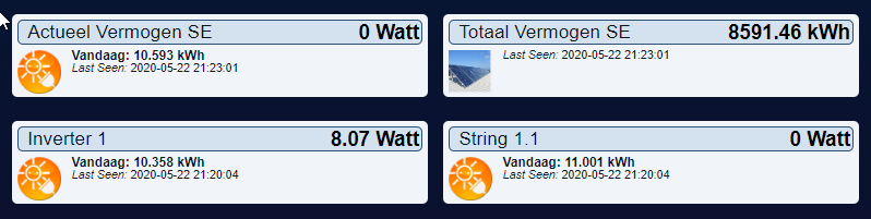

Today, I discover a difference in values of my Daily Energy Production. See picture below.
Actueel Vermogen SE = directly taken from the Inverter via a LAN connection to my RPi
Inverter 1 = With the use of the lua script from the Solaredge Monitor website
String 1.1 = With the use of the lua script from the Solaredge Monitor website
Why do I have 3 different values of Vandaag, all 3 from the same inverter.
Greetings McMelloW

McMelloW wrote: Friday 22 May 2020 21:34 Today, I discover a difference in values of my Daily Energy Production. See picture below.
What does the solaredge website say?
I don't trust my calculation to have continuous increase energy value. It has some problems on the daily rollover. I just committed a change that disables the calculation.

Dols wrote: Friday 22 May 2020 22:55 What does the solaredge website say?
This makes even more complicated. An 4th number 10.92 kWh
Greetings McMelloW
