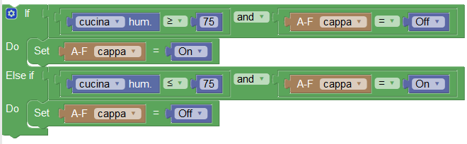

I have a blocky script than activate/deactivate a venting fan based on humidity value. The script works ok but I would like to override this behavior pushing the sonoff basic button that controls the fan. So, if I will press the button the fan should stay on until I will press the button again despite humidity level.

I solved with this script
and this rule in tasmota
rule1 on Button1#state=2 do backlog publish domoticz/in {"command":"setuservariable","idx":4,"value":"2"}; POWER TOGGLE ENDON
where idx 4 is ID of variable stato_cappa
