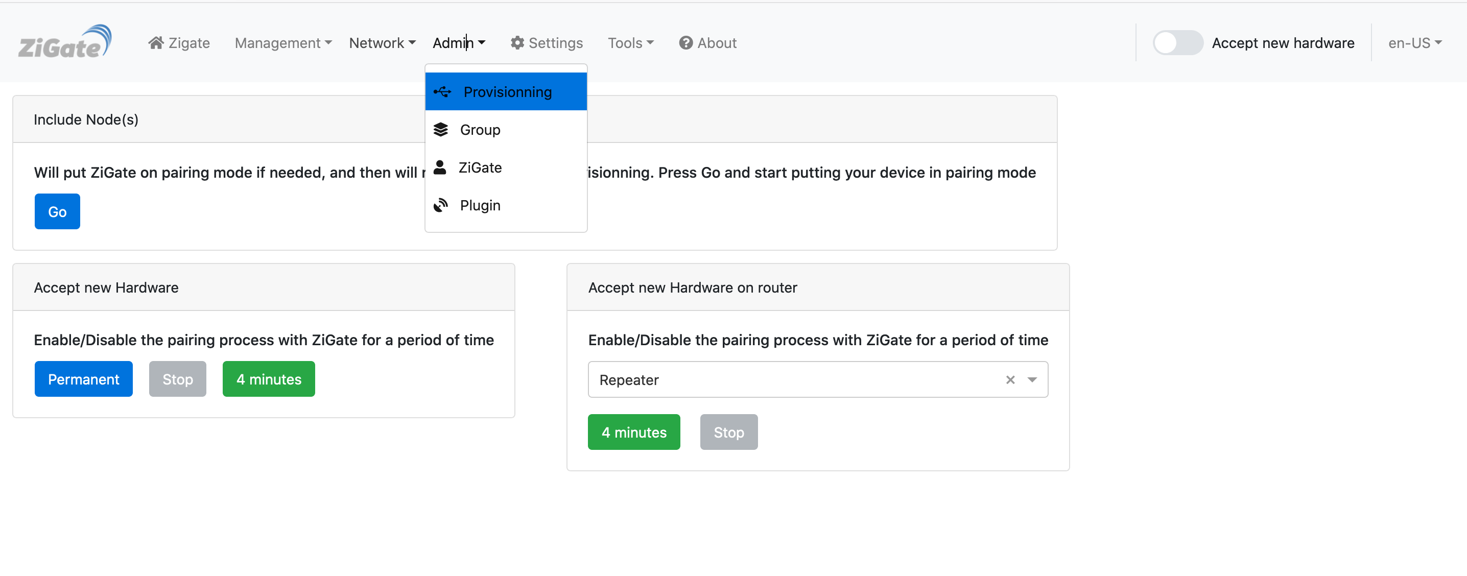

Screenshot 2020-05-10 at 16.53.25.png (226.43 KiB) Viewed 1604 times
I
f you update to the latest version on beta branch ( 4.8.026), User Interface in in place to provision on a specific router

Had to reinstall zigate to change branch to beta, it only said I hade latest version for beta but gui said 4.7.
But now i’m on 4.8.029. Tried as suggested but the aqara wont pair against the ikea repeater when its selected under ”Accept new Hardware on router”

@Ivanhoe1 , indeed I did few tests, and the repeater is not able to Accept New Hardware, while a Ikea Bulb or Ikea Plug do!
