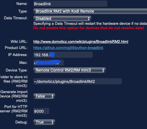

After a lot of trying and retrying I was finally able to get the plugin up and running (figuring our how to make the missing Command -switch appeared was quite a pain in the a**; maybe that should be added into the wiki?).
Anyhow, as mentioned the plugin was fired up yesterday and the command switch appeared, but for some reason the connection to my RM3 mini is gone this morning. Log shows just an error
Error: (Broadlink) Error Connecting to Broadlink device....192.168.x.x
The IP and mac address are correct, plugin.py is version 4.2, broadlink is version 0.13.1., hardware setup below. Any pointers what to do, how to proceed? Thanks in advance.

knielen, you're suggesting that older version of broadlink would solve the connection issues as well? The issues in last few posts differ slightly from my errors, but obviously that's an easy one to check.
Will try and revert - thanks.

knielen wrote: Friday 17 April 2020 20:46 Check the last 3 posts :)
Wow, it did work :o Would have never guessed, but at least the first commands are now learnt. Thanks knielen.
