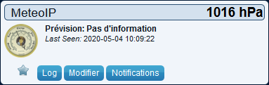

I've go to Temp-Humidity-Baro sensors on my Domoticz server. One is mySensors and have decimals on the displayed pressure value and the other is MQTT and on this one, the displayed value is rounded to an integer.
I would like have decimals on the MQTT baro value too.
D.

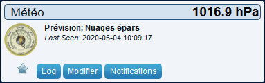

I found something :
In the database domoticz.bd (edited with sqlite3), I changed the subtype of my virtual sensor from 1 to 16.
Now it's names "weather station" in the devices list and it displays one decimal. :)
