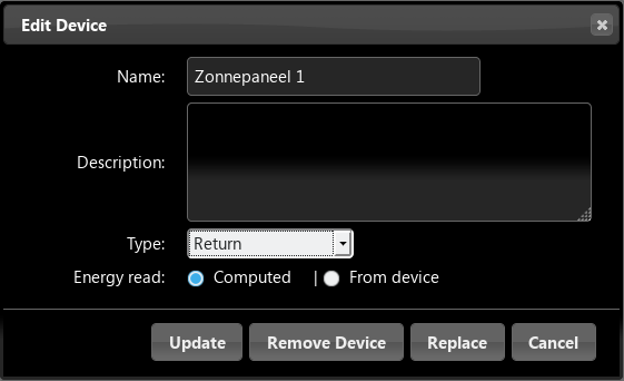

I think it is possible to use Electric (Instant and Counter)
From the Wiki:
Electricity (instant and counter)
/json.htm?type=command&param=udevice&idx=IDX&nvalue=0&svalue=POWER;ENERGY
IDX = id of your device (This number can be found in the devices tab in the column "IDX")
POWER = current power
ENERGY = cumulative energy in Watt-hours (Wh) This is an incrementing counter. (if you choose as type "Energy read : Computed", this is just a "dummy" counter, not updatable because it's the result of Domoticz calculations from POWER)
You can choose between "Computed" and "From device". You need the last one.

But it's my problem, the device don't send periodic power for domoticz can compute it, but it calcule itself the value and send power + computed energy.
So I want to use the value send by the device.
