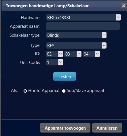

Do you have the RFXtrx433XL version and did you manually add a new switch with these options?:
Hardware: RFXtrx433XL
Name: Pick a name
Switch type: Blinds
Type: RFY
ID: Just fill in some numbers
Unit code: Just pick a number
Then click "Test" while the RFY motor is in learning state.
The motor should then add thuis switch as a new remote.
Somfy RFY.JPG (32.79 KiB) Viewed 1531 times
