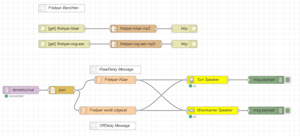

The node-red flow at the moment is:
The white comment nodes I have added to show which domoticz notification message should be used.
The ''Frietpan" ON and OFF messages are already spoken by the Google Home speakers of course, so there is no need for an extra audio message
Only the 2 delayed messages I want to use as an audio message
In the current flow the Function node "Frietpan Klaar" is based on the state of the domoticz Frietpan Switch "idx=283":

Ok fair enough. I want the frietpan messages that your DzVents script sends to Telegram, also send to Mqtt and with the same delay time. Send it to mqtt topic: domoticz/out.
Re: How to send notifications with a delay
gschmidt wrote: Friday 10 April 2020 17:25 I want the frietpan messages that your DzVents script sends to Telegram, also send to Mqtt and with the same delay time. Send it to mqtt topic: domoticz/out.
This script will do that.
