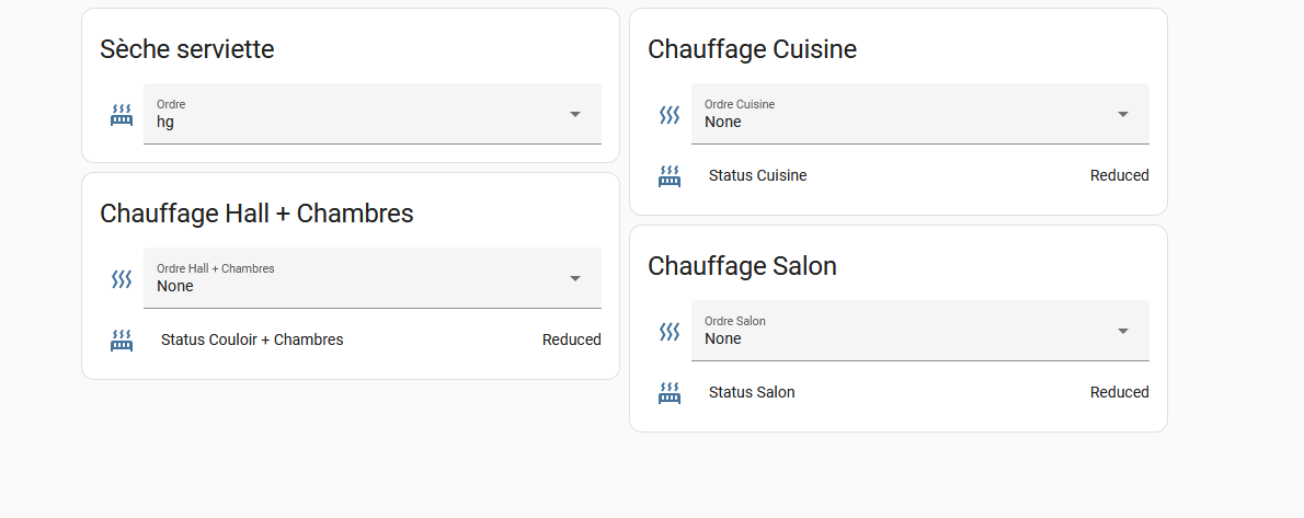

Re: X2D decoding attempt
I finally manage to work a kind of API in order to encode/decode x2d frame on c and on python. I will create the esphome application and provide all the code on the repository.
I updated the repository with the code, I can now monitor status and set order on my 3 zones.
The missing part is the way to do request on metering and temperature for example, all the structure/api can allow that but I didn't sucessfully manage to request them.
- Sans titre.png (26.04 KiB) Viewed 10250 times
