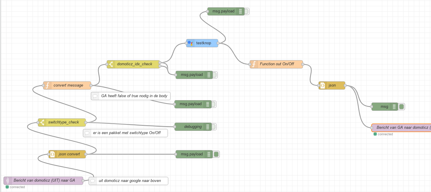

Can you post the flow and/or a screenshot of what you have created, so far?

FireWizard wrote: Friday 03 April 2020 14:47 Hi,
Thanks for helping
This is my flow

@twoenter
I have loaded your supplied flow into Node Red, and everything is fine.
You flow is more or less identical to mine, except some minor details.
Your error messages however indicate some issues with the MQTT configuration node.
Might their be any conflict? The SyntaxError (Invalid regular expression) is very strange, as there is not much you can do wrong.
However you did not insert in the outgoing node the values for QoS and Retain. I suggest you fill in the required field.
As you can see, it is connected. I have Node Red and Mosquitto running on the same device, so localhost works for me as well.
One thing is that the Topic (IDX) in your Nora node does not match with those in the split node.
So check your config.

I have a connection now.
I installed node js v12 and ran
sudo npm install node-domoticz-mqtt
see https://www.domoticz.com/forum/viewtopi ... 21&t=10190
Maybe it is not nessesary and did node 12 the trick. I don't know.
when I start node-red I see
4 Apr 12:15:27 - [info] Starting flows
4 Apr 12:15:28 - [info] Started flows
4 Apr 12:15:28 - [info] Server now running at http://127.0.0.1:1880/
4 Apr 12:15:28 - [info] [mqtt-broker:1] Connected to broker: mqtt://127.0.0.1:1883
the broker message did not show up earlier.
It is working!!

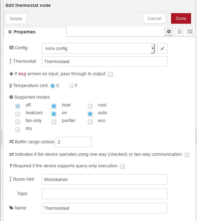

I use the thermostat node in combination with a Nefit Moduline 400 thermostat.
This thermostat has 3 different modes:
1. Auto
2. Manual
3. Off
The EMS-ESP software publishes the data to MQTT as follows:
Thermostat mode auto:
hc1: object
seltemp: 22 number
currtemp: 25.1 number
mode: "auto" string
Thermostat mode manual:
hc1: object
seltemp: 21
currtemp: 25.1
mode: "day"
Thermstat mode off:
hc1: object
seltemp: 12
currtemp: 25.2
mode: "night"
The Nora thermostat mode accepts the following nodes:
Screenshot_Thermostat-nora config.png (43.72 KiB) Viewed 2732 times
This values corresponds with the Google requirements.
You can find these at: https://developers.google.com/assistant ... uresetting
"On" is in fact not a mode, but switches back to the previous mode, if the mode is "Off"
I had to convert the modes from the thermostat (auto, day and night) to the requirements of Google Assistant and Nora.
So "auto" stays "auto", "day" (manual) becomes "heat" and "night" becomes "off".
This is done in a function node with the following contents:
var mode = {};
switch (msg.payload.hc1.mode) {
    case "auto":
    mode = "auto";
    break;
    case "day":
    mode = "heat";
    break;
    case "night":
    mode = "off";
    break;
msg.payload = {
    setpoint : msg.payload.hc1.seltemp,
    temperature : msg.payload.hc1.currtemp,
    mode : mode
return msg
This functions perfect as the following picture shows.
The problem is in fact what you see in the Google Home app and what you see and hear in the Google Nest Hub.
The Google Home app display the auto mode as "Other" and indicates nicely the room temperature.
The other two nodes "Heat" and "Off" are recognized.
If you ask the Google Nest Hub for the temperature in the Living room (Woonkamer) it will tell you that the thermostat is set to automatic mode and the setpoint is (in my case) 22 degrees. However the display shows that the current mode is not supported.
The other modes (Heat and Off) are shown if you touch the "mode button". However it will not tell you the Living room temperature, what I asked for.
At a Home Assistant thread on Github (https://github.com/home-assistant/core/issues/30009) I found the following:
Got a response from Google confirming that we should return heatcool instead of auto when the HVAC mode in Home Assistant is auto.
This thread is about an Ecobee thermostat, but I think, as it is a Google issue, that it might be applicable for all thermostats linked to Google Assistant.
Is there anybody with a similar or other experience?
I look forward to some response.
