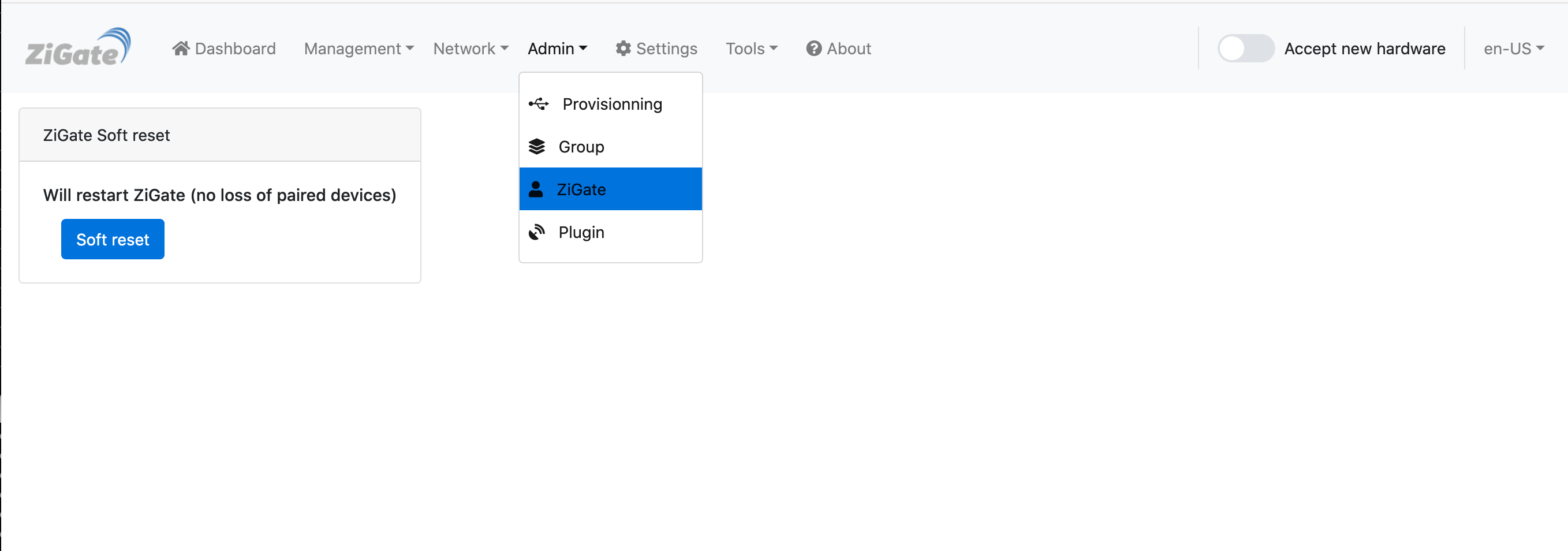

Re: Pairing issue konke motion sensor
To reset the Zigate
You have to through the Plugin Web Admin Page -> Admin -> Zigate
