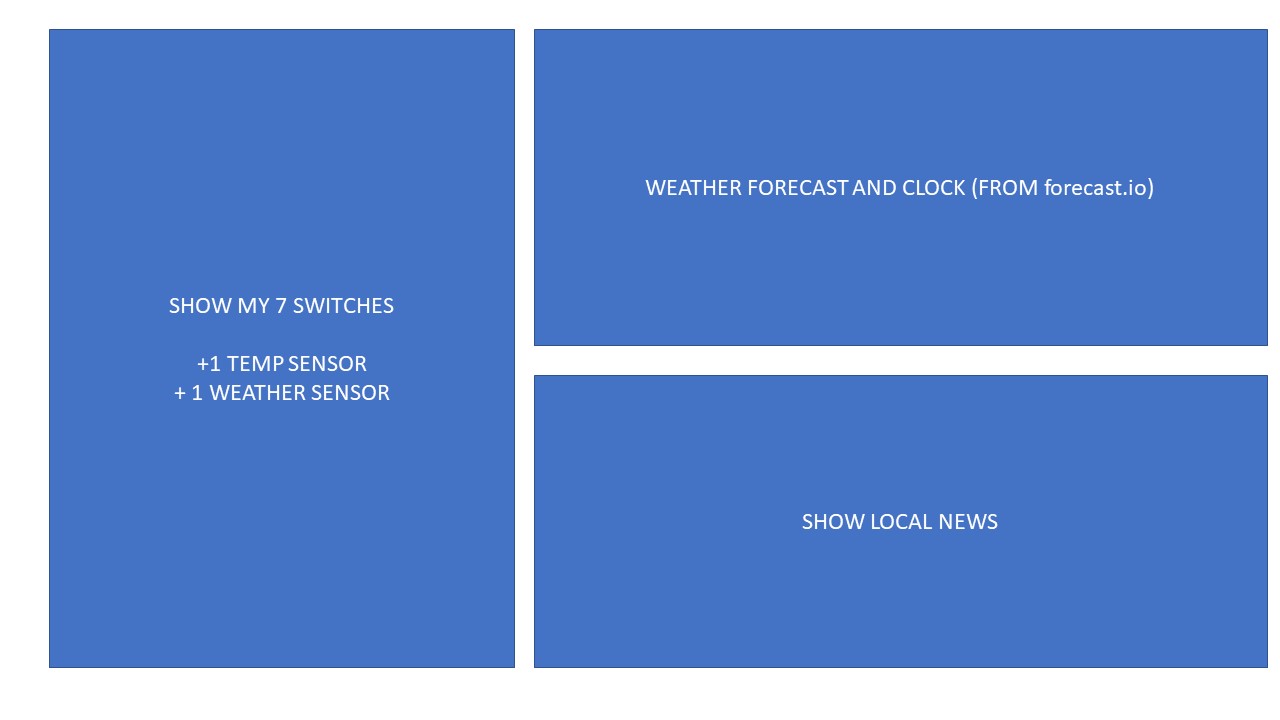

Hi All,
I have been reading a lot and experimenting, but I simply do not get it.... :(
I have a few sensors/switches in domoticz and I can see them without any issue in dashticz, but I really like to reorganize the screen like the pic below...
Can anyone tell me how to do that? I read all the documentation about blocks/columns, tried some of the config.js that some of you posted, but I can not make it work.

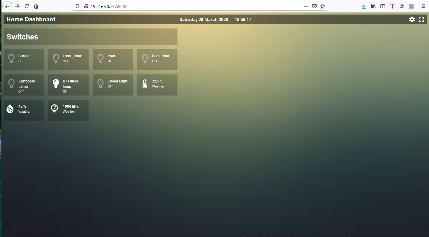

Tks so much guys for pointing me out to the right direction! Now I am making progress....
Here is how it looks like:
And here the config.js:
config.js
(834 Bytes) Downloaded 46 times
How can I group my weather sensors in a new blocktitle after the Switches (in the same column 1)?
The IDX for the weather is 2
Any help/suggestion?

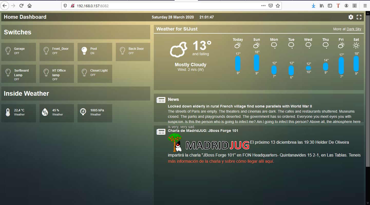

Tks Jimster and Alfagek! Now I have the first version completed! I will fine tune over the next days.
Alfagek, I will read your pm tomorrow!
Here is how it looks like and it is really simple. I will post the code tomorrow....
