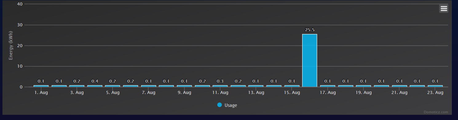

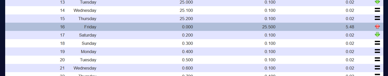

I was looking at my power consumption and saw a very high usage. Seems like the counter got reset and therefor gave me a very high usage.
Is there any way to correct this jump?

Point with your mouse to the value, you want to remove and press the "Shift" + "Left Mouse Key".
That should do the trick.

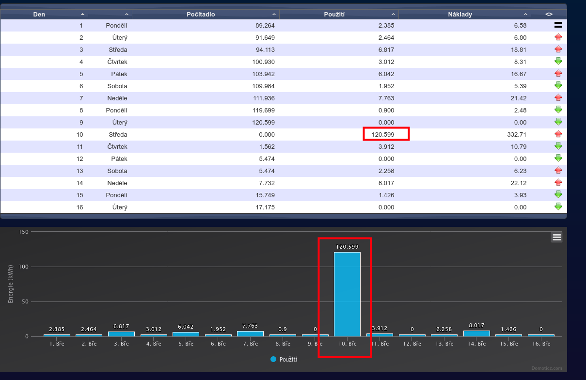

Hello, I have same problem - so high consumption after counter reset. I've tried SHIFT+"left/right click", and a lot of another combinations and no action. I've clicked on value row and also in graph and nothing happend. Where should I click? Some special setting? (I think I'm the only one administrator of my Domoticz
). Thanks in advance for some hint.

you can edit the database directly using sqlite3, or if you are on *nix, use sqlitebrowser.
the table containing the offending entry is multimeter_calender.
- stop domoticz
- reset the value to whatever you want
start domoticz
- stop domoticz
start domoticz

That delete function with Shift-left click is only working in the graphs on device log page and not in the device report page. Your screenshot shows the report page..... https://www.domoticz.com/wiki/Managing_ ... Device_Logmaxim009 wrote: Tuesday 16 March 2021 7:40 Hello, I have same problem - so high consumption after counter reset. I've tried SHIFT+"left/right click", and a lot of another combinations and no action. I've clicked on value row and also in graph and nothing happend. Where should I click? Some special setting? (I think I'm the only one administrator of my Domoticz). Thanks in advance for some hint.
So if you want to remove a really old value, older than 1 year, you have to remove it from the database manually.

.. thank you @waltervl - yes, that's it - I was on report page.waltervl wrote: Tuesday 16 March 2021 14:35 That delete function with Shift-left click is only working in the graphs on device log page and not in the device report page. Your screenshot shows the report page..... https://www.domoticz.com/wiki/Managing_ ... Device_Log
.. thank you @erem - I've edited database directly by sqlitebrowser.erem wrote: Tuesday 16 March 2021 13:57 you can edit the database directly using sqlite3, or if you are on *nix, use sqlitebrowser.
