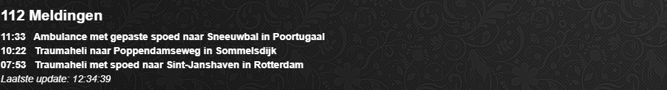

Is it possible to remove the seconds from the time? Or can I do that with css?

I need to change the code for this

- Posts: 994
Re: Dashticz - Module - 112 Meldingen (Dutch)
I’m punctual on the minute
All other blocks are using hh:mm. Than they’ll be in line with the rest then.
Maybe show seconds optional?

I just changed the code to fulfill your request wait a bit until @lokonli will merge it in the beta.HansieNL wrote: Friday 20 March 2020 18:36 Is it possible to remove the seconds from the time? Or can I do that with css?
