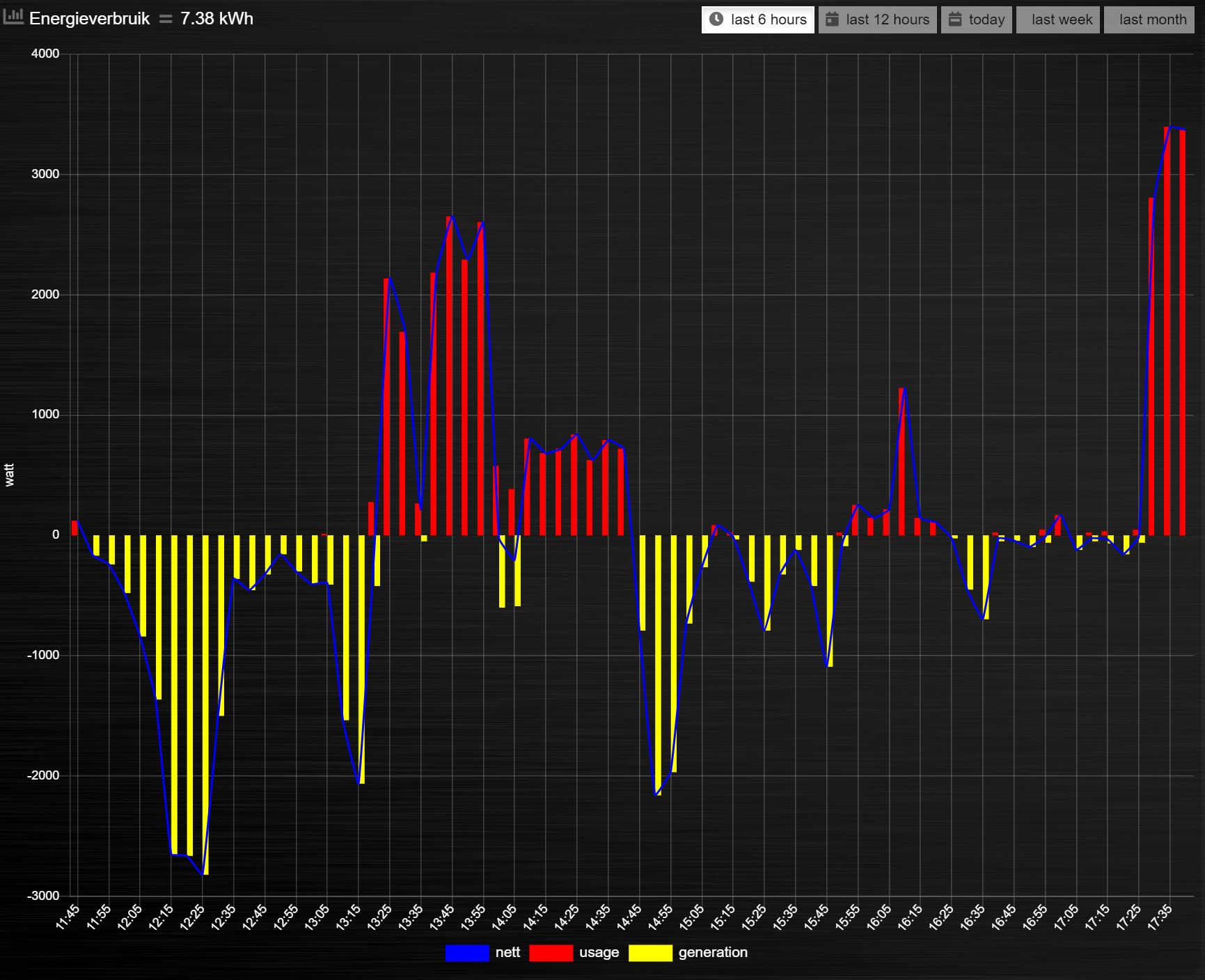

since the update to beta 3.1.4 i have some strange behaviour in my graphs. In my graphs i have 5 custom views. Before the update it always showed the last selected custom view (in my case the last 6 hours). After the update the last selected custom view is not shown anymore but it shows the default view (it seems to ignore the custom views). Does anybody know how to solve this?
blocks['energie_grafiek'] = {
	title: 'Energieverbruik',
	devices: [76],
	graph: ['line','bar','bar'],

madradrakie wrote: Tuesday 25 February 2020 21:40 since the update to beta 3.1.4 i have some strange behaviour in my graphs. In my graphs i have 5 custom views. Before the update it always showed the last selected custom view (in my case the last 6 hours). After the update the last selected custom view is not shown anymore but it shows the default view (it seems to ignore the custom views). Does anybody know how to solve this?
I take it you mean v3.3.4? This beta was last update last night.
https://github.com/Dashticz/dashticz/tree/beta
I am using custom data with the same buttons, ranges, filters and y labels as you are. I am not sure I understand what the issue is. Sorry, but please can you try and explain (again)?

madradrakie
Posts: 64
Joined: Wednesday 11 September 2019 21:24
Re: Dashticz - v3.4.0 Beta
Post by madradrakie »
it is a little bit hard to explain but i will try again.
When dashticz loads for the first time it shows the custom 6 hour view. See below.

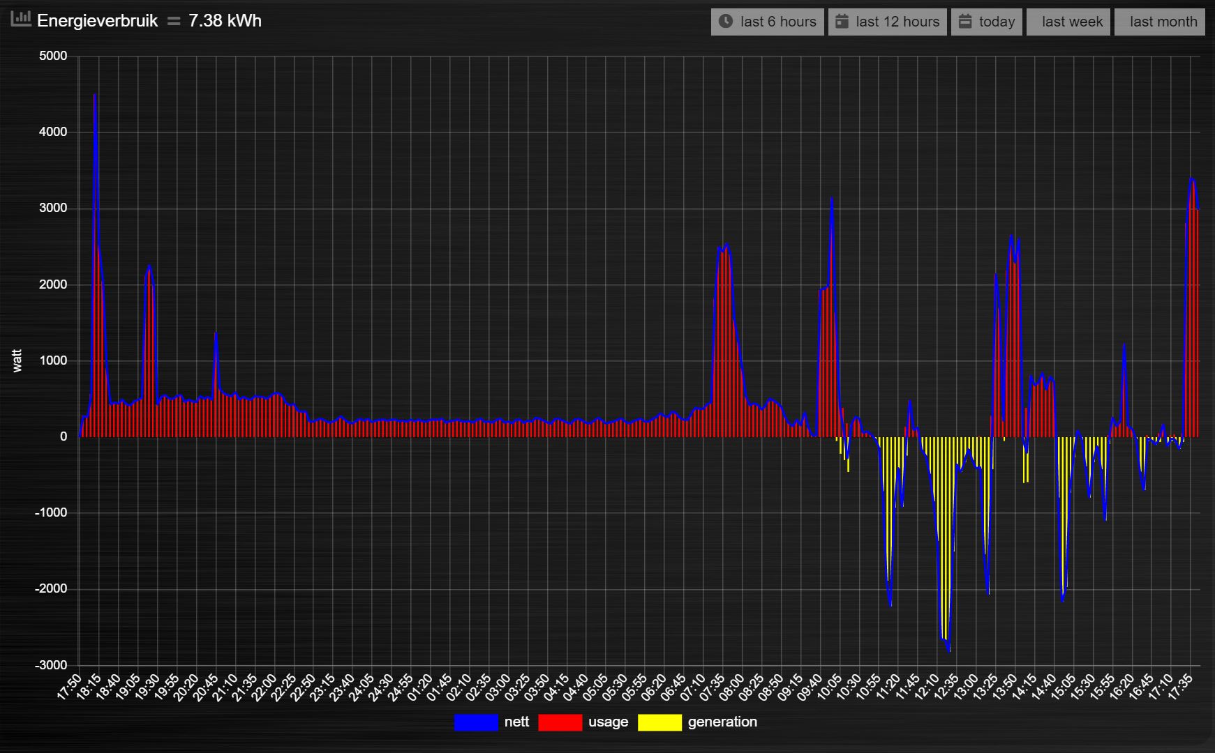

After 5-10 minutes the graph looks like this (i think it refreshes or something like that?)
It seems that after the refresh the custum view is ignored because then the graph looks like this:
In the previous version of dashticz this was not the case and the custom 6 hour view of the graph always showed.
clinkadink
Posts: 417
Location: Swindon, UK
Post by clinkadink »
madradrakie wrote: Wednesday 26 February 2020 17:46 After 5-10 minutes the graph looks like this (i think it refreshes or something like that?)
Thanks for clarifying. I have now replicated this bug. I will fix, cheers ;)

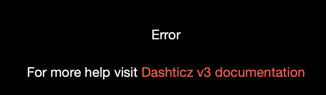

I upgraded to version 3.4 today.
Copied my existing configuration file (see below) and when I refresh Dashticz it says error (see screenshot)
Can anyone please push me in the right direction to solve this, instead of starting al over with an clean config.
Any help is more than welcome
Schermafbeelding 2020-02-27 om 12.40.30.png (28.15 KiB) Viewed 1765 times

Lokonli
Posts: 2292
Post by Lokonli »
The Domoticz IP, 'http://127.0.0.1:8080', probably is not correct.
This way you can only open the browser on local host.
Further, the 'image' parameter in the buttons have been renamed to 'btnimage'

RduPre wrote: Thursday 27 February 2020 12:42 I upgraded to version 3.4 today.

var config = {}
config['language'] = 'nl_NL';

Can you try to remove / comment the following line: var variables = {}
Blah blah blah
RduPre
Posts: 53
Joined: Thursday 11 August 2016 18:41
Post by RduPre »
This has no effect :-(
HansieNL
Posts: 969
Post by HansieNL »
RduPre wrote: Thursday 27 February 2020 17:26
Tried to load your CONFIG.js here and it is loading. Do you have changed custom.js and/or custom.css?
Blah blah blah
RduPre
Posts: 53
Post by RduPre »
Yes I did (forgot to mention it)
CUSTOM CSS FILE
.block_v1 .value {
color: deepskyblue;
font-size: 20px;
#newsTicker li {
font-size:20px !important;
.col-data span	{ font-size: 30px; margin-left: 25px; font-weight: 600; color: deepskyblue; font-variant: small-caps;}
/*.col-data .title 		{ font-size: 25px; margin-right: 25px; font-weight:220; color: dodgerblue;font-variant: small-caps;}*/
.containsicalendar {
.containsicalendar .items {
  font-size: 175%;
.publictransport div {
    font-size: 20px;
.title {
    font-size:20px;
#newsTicker li {
 //add custom javascript in here
function afterGetDevices(){
function getExtendedBlockTypes(blocktypes){
	return blocktypes;
function getStatus_518(idx,value,device){
   if(parseFloat(device['Usage'])>0){
      blocks['514_1']['icon'] = 'fas fa-sun slow-spin'; //if you use "fa-spin" instead of "slow-spin" then it is not necessary to add code to custom.css
      blocks['514_2']['icon'] = 'fas fa-sun slow-spin'; //if you use "fa-spin" instead of "slow-spin" then it is not necessary to add code to custom.css
      blocks['514_3']['icon'] = 'fas fa-sun slow-spin'; //if you use "fa-spin" instead of "slow-spin" then it is not necessary to add code to custom.css
   else {
      blocks['514_1']['icon'] = 'fas fa-sun';
      blocks['514_2']['icon'] = 'fas fa-sun';
      blocks['514_3']['icon'] = 'fas fa-sun';
   /* Buienradar */
//blocks_1384 {
//;  height: 100%;
//function getStatus_131(idx,device){
//   if(device['Switch']=='On'){
//      blocks[131]['icon'] = 'fa fa-bell faa-ring animated fa-4x'; //if you use "fa-spin" instead of "slow-spin" then it is not necessary to add code to custom.css
//   else {
//      blocks[131]['icon'] = 'fas fa-sun';
clinkadink
Posts: 417
RduPre wrote: Thursday 27 February 2020 18:50 Yes I did (forgot to mention it)
Missing a closing bracket on the newsTicker in your custom.css.
There is a random closing bracket half way down your custom.js.
clinkadink
Posts: 417
madradrakie wrote: Wednesday 26 February 2020 19:39 thanks in advance! :D
The beta was updated to include this fix last night. Fingers crossed - this solves the refresh issue ;)
RduPre
Posts: 53
Post by RduPre »
clinkadink wrote: Thursday 27 February 2020 19:22
I don't know how to adjust it to get it working. The 2 custom files did work on the previous release.
Jimster
Posts: 82
Joined: Tuesday 04 February 2020 11:42
Post by Jimster »
RduPre wrote: Friday 28 February 2020 9:10
Remove parts of your custom.js and save it to check if it works without that part. Continue until you find where the issue is.
