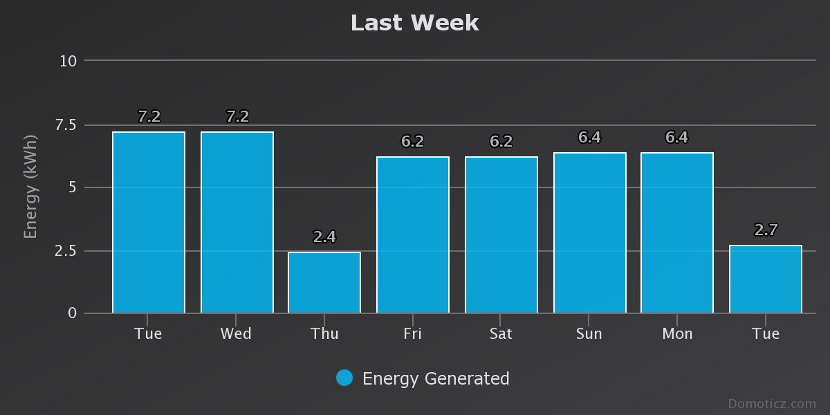

It seems there is still an issue with the daily production. Very often a value is used for two consecutive days, as you can see in the image. The correct values should be:
Tue 7.2
Wed 2.4
Thu 1.7
Fri 6.2
Sat 5.6
Sun 6.4
Mon 2.7
Tue 0.3
So, often the value of the previous day is used, but not always.
EDIT: it seems like the previous day is used when its value is larger than the current day value.
Gruzi
Joined: Friday 28 February 2020 9:06
Re: GoodWe Solar: get data from the new semsportal (lua script)
Post by Gruzi »
Same behaviour here.
Values should be (checked on Sems portal) :
Wed - 5.8
Thu - 2.4
Fri - 8.6
Sat - 9
Sun - 13.2
Mon - 4.5
Tue - 20.5
It is also remarkable that today Wed is already filled in with 20.5
Gruzi
Post by Gruzi »
@CrazyFrog @Sandeman684
I investigated further and I think that the problem Sandeman684 and I have is not caused by the script from Crazyfrog.
The script is giving Domoticz the right values for Power and Energy (I created logfiles over the day) but Domoticz doesn't process them well.
This seems a more common problem from the sensor Electric (Instant and Counter) and I found another post on the forum where I have reported this.
See my post:
https://www.domoticz.com/forum/viewtopi ... 73#p241673
