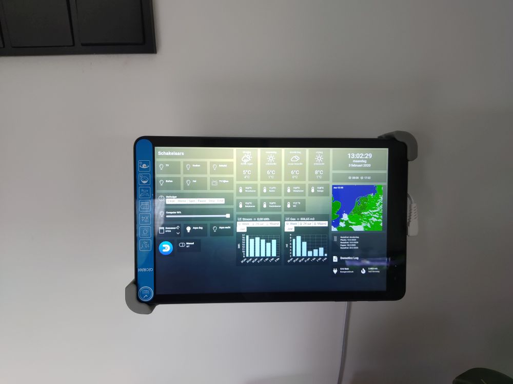

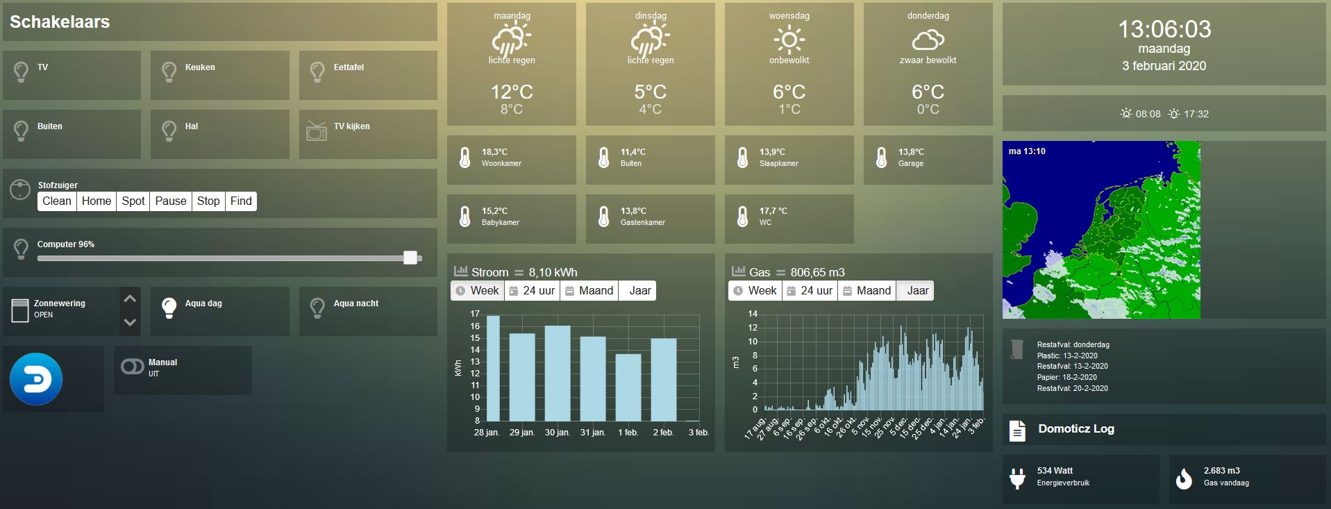

Post by lotte3500 »
My dashboard:
Also installed a tablet:
CONFIG.js:

There is only one thing I am not happy about at the moment. With the graphs, when I select 'Year' I want to have the values summed by month, now it shows per day (see the right graph 'Gas' above). Does anyone have an idea on how to accomplish that?
