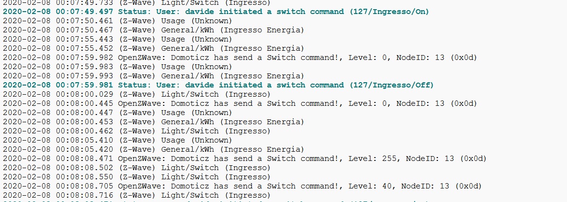

Hi everyone I use this code to dim the lights according to the time and some switches, it works perfectly, only it sends the z-wave network in tilt by sending the same command twice both when I turn on the light and when off here is a log screen? is there any way to improve the code? thank you

Yes it is. I noticed this behavior before but dzVents is only sending the commands once so cannot be solved by changing dzVents code.
