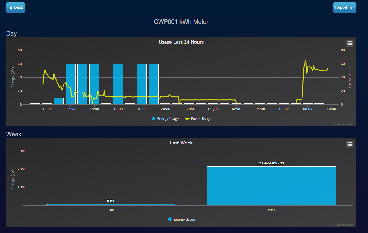

As I ran into the same issue this week, I did some investigation.
The first value reported was -21474837,23 (note: EU notation of decimal separator). Multiplying this value by 1000 and converting it to a hexadecimal value will result in FAFFFFFD10. Hence that this number contains 10 digits, which is quite unusual in computer environments: A normal integer nowadays is stored in 2 (short), 4 (int), or 8 (long) bytes or 4, 8, or 16 hexadecimal digits.
So I expect this value is incorrectly retrieved / interpreted from the received Z-wave message from the device. When you cut off the upper 2 digits, and interpret the left over 8 digits as a long integer, this will result in -752. Still a negative number, but much more an expected value. I've no idea what the upper 2 digits mean: This could be part of another parameter or some kind of floating point notation, I guess.
For the next day, it reported -21474839,93. After multiplication and conversion, this will result in FAFFFFF284. After cutting off the top two digits, this will result in an integer value of -3452, a difference of -2700 ( -2,7 kWh).
Another thing that attracted my attention where the software versions reported by the device: Library V3, Protocol V6.04, and Application V2.21. My older devices report Library V3, Protocol V.4.05 (lower), and Application V3.94 (Higher!!!!). So I assume that this issue is introduced by a change of firmware in the devices: Older devices use protocol version 4.05 and more recent devices use version 6.04.
This might also explain why the newer devices don't report a Device ID and Serial Number (The fields are empty). And a final difference I noticed was that Domoticz shows an extra field for the failing device: Secured: Disabled. Strange, because I added the device by using the "Add secure" to add the device to the network.

For some reason, something has changed since yesterday: I just did the same export from the Domoticz graph as I did yesterday evening and now I get about the same numbers, but just positive
I did not changed anything in the database or ran any scripts to correct those values.
However, this does not change my conclusion: The message layout has changed due to a protocol version update.
Here are the updated figures:
Maybe someone with knowledge about the protocols used, can respond to this?

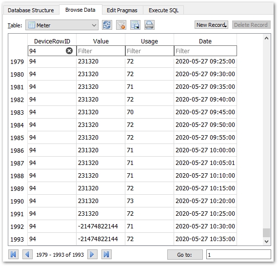

SchulieBug
- Posts: 4
- Joined: Monday 25 March 2019 16:04
Re: Neo CoolCam Power plug 12A+ problem with kWh
I do have the same issue and have implemented the script mentioned in this topic. However, when I look in the database, Meter table, I see large negative numbers in the Value field (not anymore in the usage). How do I get rid of these false values?
As an example: What can I do to get rid of these values (besides dropping the Neo Coolcam's)?

Wich application are you using here?SchulieBug wrote: Wednesday 27 May 2020 10:58 I do have the same issue and have implemented the script mentioned in this topic. However, when I look in the database, Meter table, I see large negative numbers in the Value field (not anymore in the usage). How do I get rid of these false values?
As an example:
SchulieBug
- Posts: 4
Bolten88
- Posts: 6
- Joined: Tuesday 16 June 2020 5:14
Thanks!SchulieBug wrote: Wednesday 17 June 2020 9:50Export the database from within Domoticz and open it with SQ Lite Database Browser Portable (download it here)
