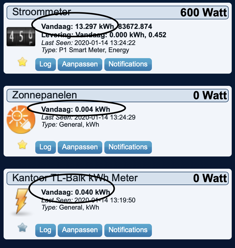

I got it working, but due to the the realtime measurements are not at the same time of al devices, it's not accurate (sometimes even a negative value)
Is it possible to use the daily usage instead (see image below)
Schermafbeelding 2020-01-14 om 13.24.32.png (214.27 KiB) Viewed 1530 times
Re: Calculate other energy usage using dzVents
RduPre wrote: Tuesday 14 January 2020 14:13 I got it working, but due to the the realtime measurements are not at the same time of al devices, it's not accurate (sometimes even a negative value)
Is it possible to use the daily usage instead ?
I guess this should do that (not tested)
return
    on =
        devices =
            'Power',   --  'name' or id of your P1 device
    execute = function(dz, item)
        local usage = item.counterToday -- P1 used Today
        local allMeasured = { 679, 915, 2326 } -- id's of all measured devices
        local delta = usage
        for _, id in ipairs(allMeasured) do
            delta = delta - ( dz.devices(id).counterToday )
        dz.log('Usage by none measured power consumers  = ' .. delta )
