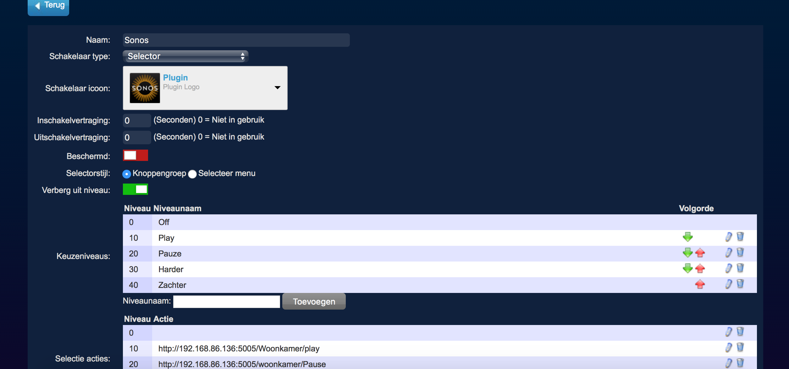

its exactly the same
- Schermafbeelding 2018-09-16 om 13.59.21.png (312.64 KiB) Viewed 7348 times

Almost out of idea's. Apparently the link between the button and the device is gone.
I would delete the selector switch and the dummy.
Then recreate a dummy for each Sonos group/or device. Recreate the selector switch for each Sonos group/or device
Re: Step by step guide: Sonos integration
yes that did the trick! its working now in Domoticz. Do you also how to run the api continuously, now, when I close the terminal de pipe is broken. Is there an option within synology which I can use?
