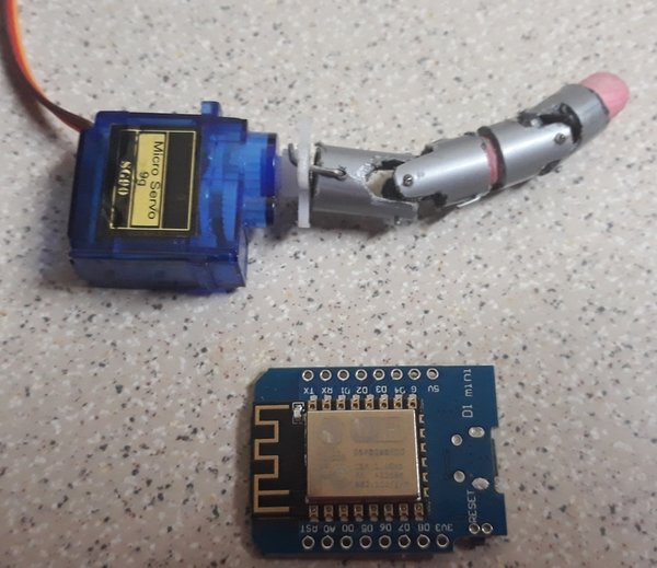

still in test phase but works great
Wemos d1 mini - Espeasy firmware
Servo sg90
Cardan joint - home made
[youtube] https://youtu.be/bK5VLNLT7_g [/youtube]
Control from Domoticz (open , close , servo position from 0 to 100%)
Servo sg90
-- Blinds dimmer script using ESPEasy by mojso

return commandArray- Attachments
- s1.jpg (60.57 KiB) Viewed 1510 times

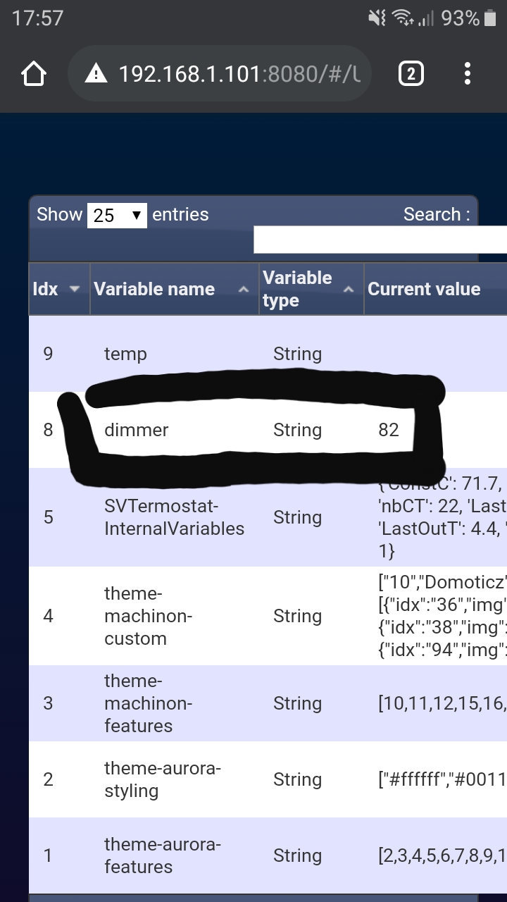

mojso
- Posts: 94
- Joined: Friday 08 November 2019 23:07
Re: Venetian Blinds over esp8266
-- 1. Put the script in Events as Lua script
-- 2. In setup -> more option --> user variable
put in variable name dimmer ,
variable type string and update
-- 3.Setup -> Hardware dymmy device create virtual device, Select rgb switch, Then in Switches find the created device end click edit. then in switch type select blinds precentage and save

mojso
- Posts: 94
- 20201221_175749.jpg (227.7 KiB) Viewed 1251 times
pietje1951
- Posts: 11
- Joined: Sunday 08 November 2020 21:03
It Works!
I didn't read properly, sorry !
Thank you very much!
