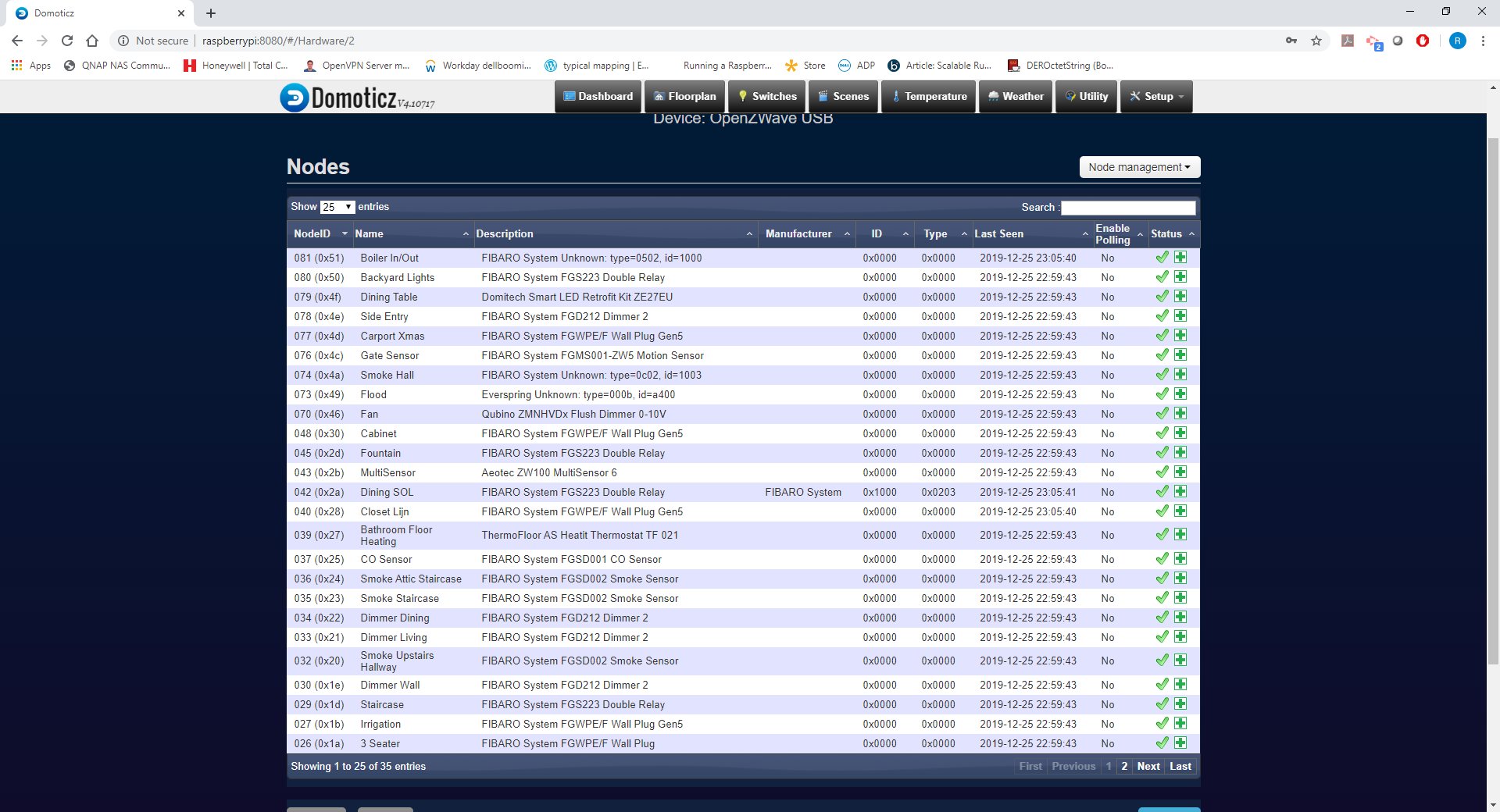

Decided to upgrade to latest Beta as there were some issues in Evohome integration (showing offline constantly). After upgrade some things were not working properly anymore so decided to put back my latest stable release and backed up config/scripts/database.
However, whatever I try to do now, only a couple of nodes come back up in the list of hardware. It looks like my whole setup is completely ruined. Also going back to Beta doesn't help. Also there only a couple of nodes come back up!
In the Beta, my z-stick shows having v1.6 whereas going back to latest stable release it shows having v1.4.
What is wrong?? This whole config has been working fine for many, many months and now seems completely ruined by latest Beta!!!
Upgrade to latest Beta completely ruined my Z-wave config

- Image1.jpg (319.41 KiB) Viewed 382 times

Re: Upgrade to latest Beta completely ruined my Z-wave config
