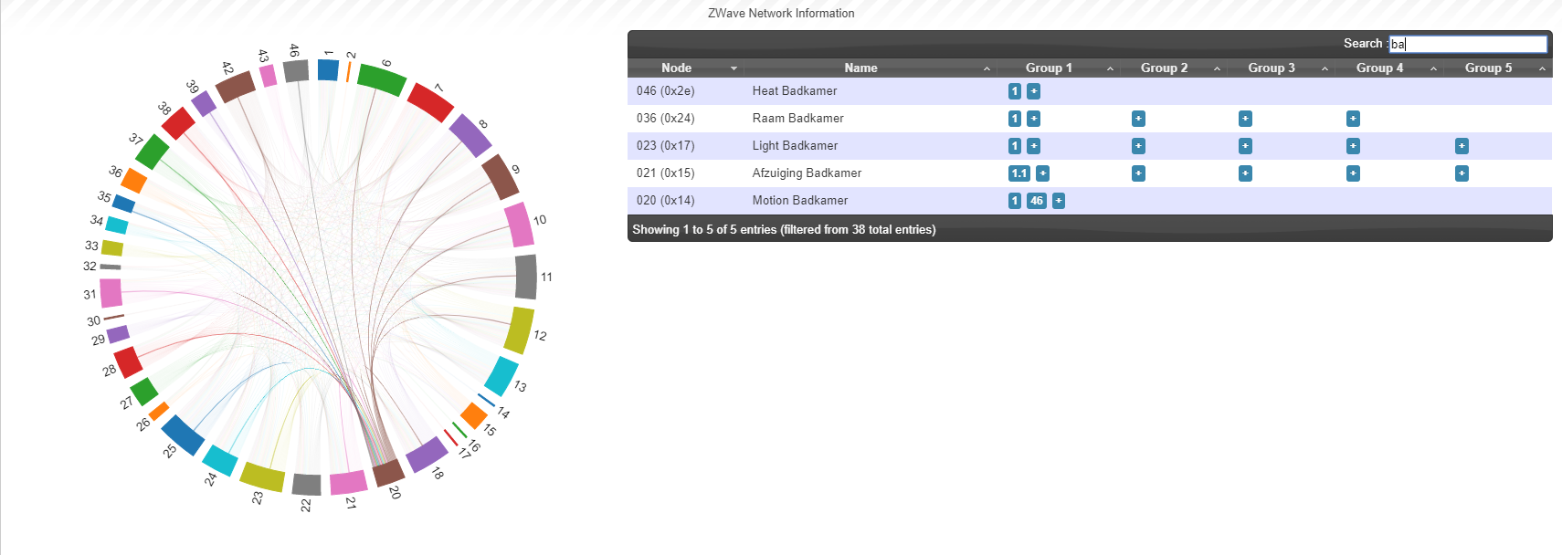

I have the association because the Eurotronic Spirit is in the addict, and he controlls the heat in de badroom. So I told him to look at an external sensor and assiciated him with the Aeon multisensor for the temp in the badroom. Is there another way to do this? I made the association by Domoticz via "Groups & Networks"
I did exclude, factory reset and include again. At first he didn't heat him until the temp got under the setpoint. But once he started again he starts overheating again I included the log of the heating so you can see how he does it. Simply on and of instead of percentages.But more importand almost always on. Also during day when the setpoint is 8 degrees...
I'm not sure if node 22 is directly connected to the controller, how can I check this? Can you see it in the netwerkoverviews?
Log Heating.png (97.03 KiB) Viewed 1186 times
Network info.png (271.85 KiB) Viewed 1186 times

You can see the connections in your lower screenshot, but you have to hover over the block with 22 on it's side. Then there should be colored line to node 1 controller.
