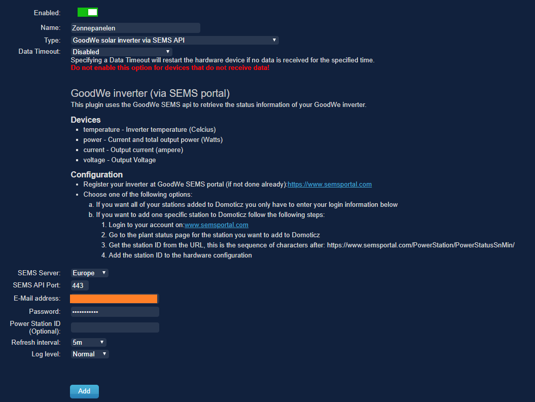

Goodwe HW panel.png (46.74 KiB) Viewed 5068 times

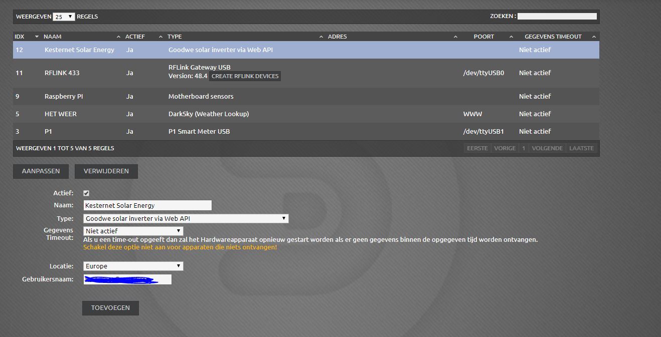

Sorry for the late reply, busy busy busy. How do i set loglevel to debug??
This is what i see in Domoticz:

Re: Python Plugin: GoodWe solar inverter via SEMS API
Post by JanJaap »
Hi Nodri, you are using the wrong plugin. This is the domoticz build in one that doesn't work anymore. Did you follow instructions to install the plugin correctly? Please mind to restart domoticz to activate any newly installed plugin.

I did everything that was on this page:
https://github.com/dylian94/domoticz-GoodWeSEMS
The Goodwe solar inverter via Web API shows up but not the SEMS portal api thing.
Restarted several times now.

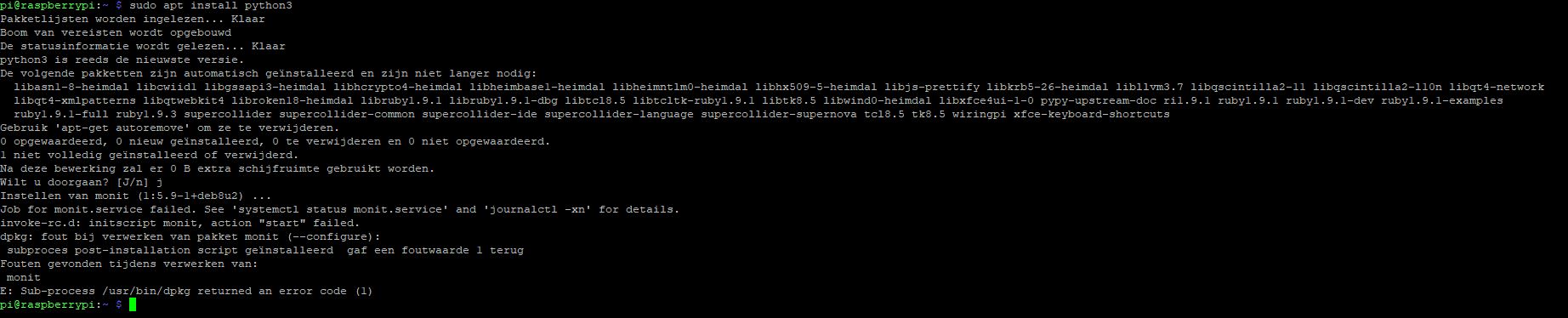

So i updated the debian stuff but when i want to install python3 i get this:
Post by JanJaap »
Hi Nodri,
That's well beyond my knowledge. When I googled the previous time I got the link I mentioned in the previous post.
Since this is no longer concerning the GoodWE plugin, I propose you open a new topic about the Python framework to keep this thread clear.

Then switch on debug logging. And please show me a screenshot of your configuration to see what you are doing. I presume you have filled in the optional Station ID? It should be some GUID which should be the last part (after the las '/') of the URL when you log in to the SEMS portal via a webbrowser, url should be something like:
https://www.semsportal.com/PowerStation ... usSnMin/<8 char hex>-<4 char hex>-<4 char hex>-<4 char hex>-<12 char hex>
