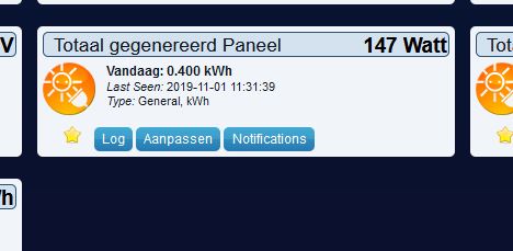

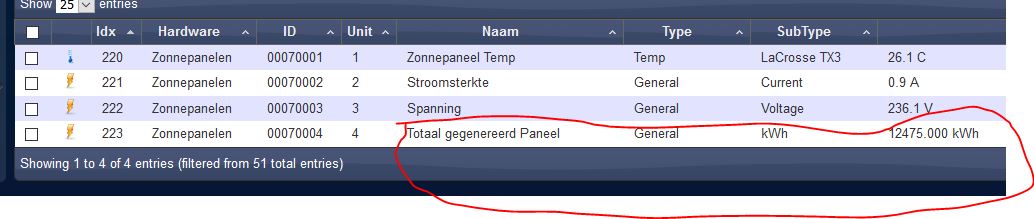

Although the "Devices" (Apparaten) tab shows the total generation of my panels over the years (12475.100kWh) the representation of it shows only the daily generation.
Hope the pictures explain.
I tried to play around with the line :
Devices[self.baseDeviceIndex + 4].Update(nValue=0, sValue=str(inverter["output_power"]) + ";" + str(inverter["etotal"] * 1000))
In the python script, but (I cleared cache in the browser) this did not work for me.
I did some logging on it and found the following line in the log:
2019-11-01 12:27:47.073 (Totaal gegenereerd Paneel) Updating device from 0:'382W;12475200.0' to have values 0:'392W;12475300.0'.
So looking at this, the update is correct but the "Domotics switch" shows only the first value (382W) and disregarding the second value (12475300)
With regards
Henk
With regards
Henk

JanJaap
- Posts: 245
- Joined: Thursday 12 October 2017 20:46
- Domoticz version: Dev
- Location: the Netherlands
Re: Python Plugin: GoodWe solar inverter via SEMS API
Hi Henk,
The domoticz plug shows you the actual power (in Watt) not the total. You will see totals when you click the 'log' button. The control will show the sum of the day only indeed. If you want a cumulative, you can export the data in the log section.
I'm working on an update of the plugin, can see if I can fit a total in as well (data does not seem to be reported via the SEMS API so may need to do some adding in the plugin.

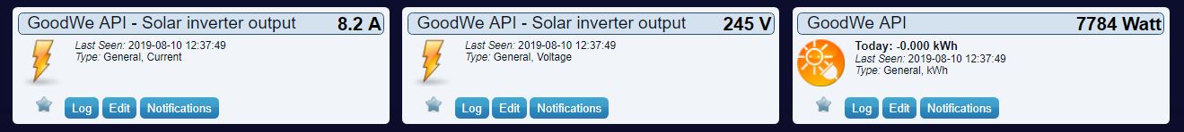

uermend
- Posts: 5
- Joined: Monday 11 February 2019 11:10
- Domoticz version: 4.10055
hi,
You probably need to upgrade to get the screen listed below. I have it running on the lates beta version V4.11468.

Wich screen?
By the way, did an ./updatebeta so I am on version 4.11474.
Even after browser refresh and clearing cache the problem stays.
String has 2 valeus but only representing one.
