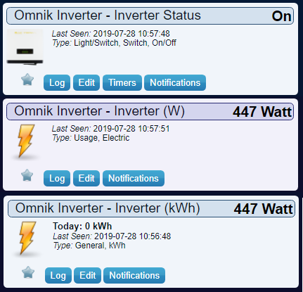

So I started to create this Plugin it works with an Omnik4000 v1.
https://github.com/sincze/Domoticz-Omni ... ree/master
It will read data from the inverter itself that is available in the webinterface.
Prereqs: Python version 3.5 & Domoticz V4.11034 (beta)

I have put the plugin to Domoticz and it works partly.
I get 3 devices but only the 'switch' stating the status of the inverter works. The power is 0 and the kWh is 0.
My inverter is caled solarsmart. If i give the /js/status.js I get the following string
So it reads the values but they are not processed.
Who can help
var webData="A0415D0056,V1.10,V1.10,SolarSmart 2.5KW, 2500,26,17,80484,,1,"; Who can help
