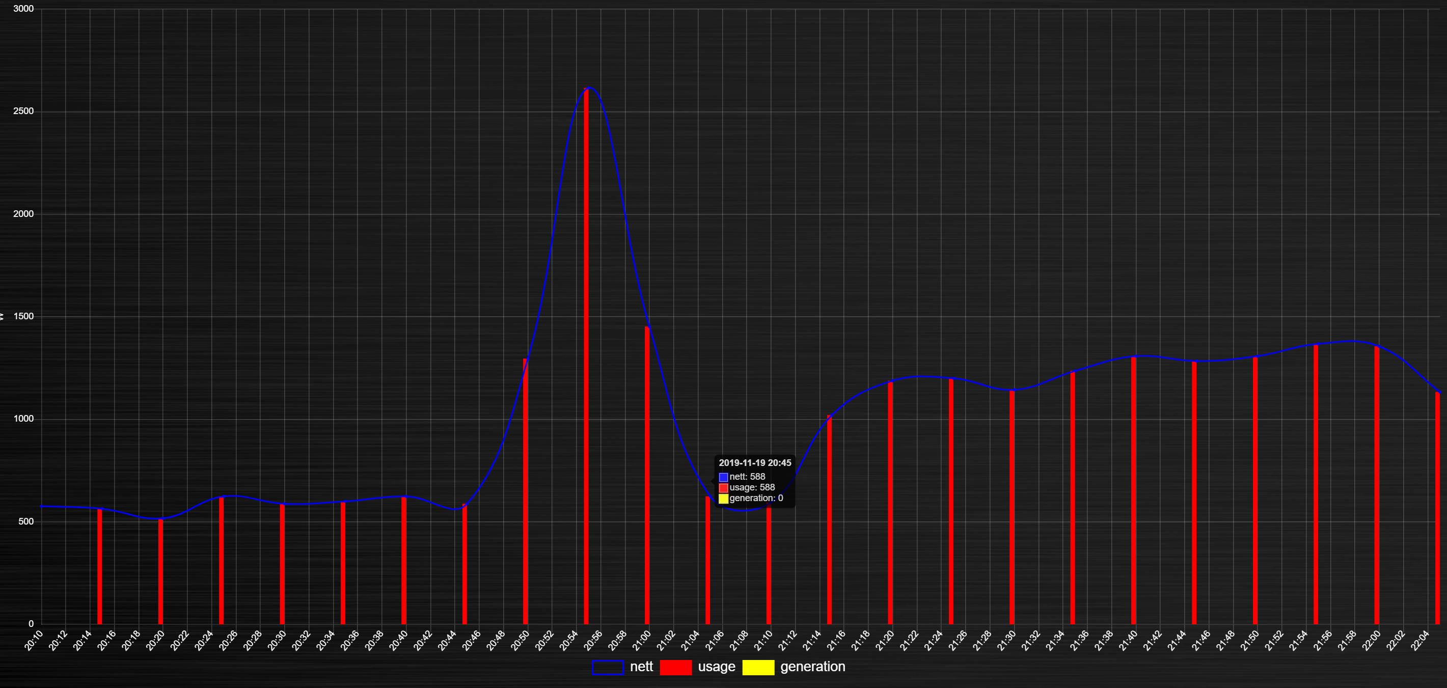

After updating to the new beta my graphs are shown like this. How can i make the bars thicker just like in the previous version?
This is the code i use at the moment. Thanks for your help
blocks['graph_76'] = {
	title: 'Energieverbruik',
	graph: ['line','bar','bar'],
	datasetColors:['blue','red','yellow'],
	legend: true,
	displayFormats : {
    		minute: 'kk:mm',
		hour: 'D MMM',
		day: 'll',
      		week: 'ww',
	      	month: 'MMM D',},
	custom :{
        	"last hours": {
	            range: 'day',
        	    filter: '6 hours',
	            data: {
        	        nett: 'd.v+d.v2-d.r1-d.r2',
                	usage: 'd.v+d.v2',
	                generation: '-d.r1-d.r2'
        	"today": {
	            range: 'day',
        	    filter: '10 hours',
	            data: {
                	usage: 'd.v+d.v2',
        	"last week": {
	            range: 'month',
        	    filter: '1 week',
	            data: {
                	usage: 'd.v+d.v2',
        	"last month": {
	            range: 'year',
        	    filter: '1 months',
	            data: {
                	usage: 'd.v+d.v2',

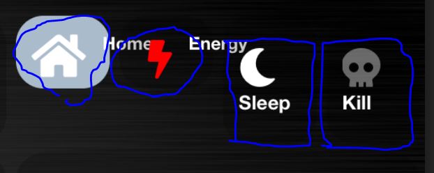

and another question. After updating to the new version two of my buttons (which i use for hyperlinks to another slide) are very big. I can not find the problem.
This is the part of the code i always used.
buttons.p1 = {key: 'Scenes', width:3, icon: 'fas fa-home', title: 'Home',slide:1 }
buttons.p2 = {key: 'Beneden', width:2, btnimage: 'img/favicon/largetile.png', title: 'P.2',slide:2 }
buttons.p3 = {key: 'Boven', width:2, btnimage: 'img/favicon/largetile.png', title: 'P.3',slide:3 }
buttons.p4 = {key: 'Energie', width:3, icon: 'fas fa-bolt', title: 'Power',slide:4 }
buttons.p5 = {key: 'Water', width:3, icon: 'fas fa-shower', title: 'Water',slide:5 }
buttons.p6 = {key: 'Muziek', width:2, btnimage: 'img/favicon/largetile.png', title: 'P.6',slide:6 }

What was your previous version?

Which buttons are bigger? What do you mean with very big?
In beta v3.2.0 the default size of button titles was changed. You can change it via custom.css. Probably:
.dt_title {
	font-size: 100%;
madradrakie

The previous version was 3.1.2. It looks like the graphs shows a value which is given by Domoticz every 5 minutes. But the x-axes shows a value every minute. In the previous version the graph only showed a value every 5 minutes and that is probably why the bars appeared bigger?

your solution worked but the buttons have a different height than for example my scenes or light buttons (see image). Also the text is shown right from the icon instead of beneath. Is it possible to adjust these things in for example the css file? Do you know how? I have searched the forum but could not find the solution yet.

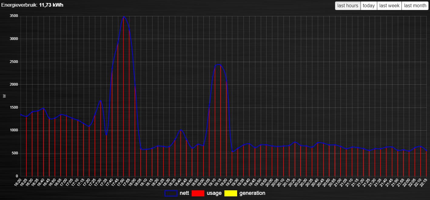

madradrakie wrote: Tuesday 19 November 2019 20:57
Lokonli wrote: Monday 18 November 2019 22:51
madradrakie wrote: Monday 18 November 2019 22:22 After updating to the new beta my graphs are shown like this. How can i make the bars thicker just like in the previous version?
	legend: true,
	displayFormats : {
    		minute: 'kk:mm',
		hour: 'D MMM',
		day: 'll',
      		week: 'ww',
	      	month: 'MMM D',},
	custom :{
        	"last hours": {
	            range: 'day',
        	    filter: '6 hours',
	            data: {
                	usage: 'd.v+d.v2',
        	"today": {
	            range: 'day',
        	    filter: '10 hours',
	            data: {
                	usage: 'd.v+d.v2',
        	"last week": {
	            range: 'month',
        	    filter: '1 week',
	            data: {
                	usage: 'd.v+d.v2',
        	"last month": {
	            range: 'year',
        	    filter: '1 months',
	            data: {
                	usage: 'd.v+d.v2',
I think that is the reason indeed. It might be a side effect of the latest version of the chart.js module that is being used.
You can modify the x-axis behavior by adding the following to the block definition:
    options: {
        scales: {
            xAxes: [{
                    distribution: 'series'
Probably I'll will make this default in the next beta release.
