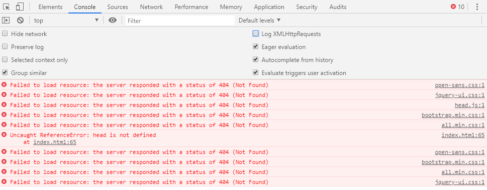

pvklink
Posts: 822
Joined: Wednesday 12 November 2014 15:01
Domoticz version: latest b
Re: v3.2.0 beta
Post by pvklink »
see attachment..
i do have a working copy 3.1
Jablotron connection, Ikea
Lokonli
Posts: 2292
Re: v3.2.0 beta
Post by Lokonli »
In v3.2.0 most dependencies are bundles into bundle.js. I see somehow the files still are requested, which should not happen.
It seems you have an old index.html. Did you try to refresh the cache?
or:
How did you install Dashticz? Which www server are you using?
