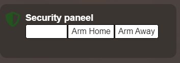

Only part that is not ok is the selected/active button color.
I tried to add it my self by adding .btn.active
.block_1728 {
    height: 120px !important;
    background-color: rgb(59,53,50) !important;
.block_1728 .title {
    font-size: 18px !important;
    color: white;
.block_1728 .btn {
    background-color: white!important;
    border-color: black !important;
    font-size: 16px !important;
.block_1728 .btn.active {
    color: black;
    background-color: green!important;
    font-size: 10px !important;
Jablotron connection, Ikea

pvklink wrote: Wednesday 13 November 2019 22:17 oeps, changed the wrong message
.block_1728 {
    color: white;
.block_1728 .btn {
    color: black;
I think you forgot to add a space between green and !important... and that’s !important ;-)

pvklink
Posts: 822
Joined: Wednesday 12 November 2014 15:01
Domoticz version: latest b
Re: v3.2.0 beta
Post by pvklink »
does not work either...
strange, perhaps the secpanel device is a different object ...or a bug ?
background-color: green !important;

Posts: 994
Re: v3.2.0 beta
Post by HansieNL »
I don’t know if this works:
[data-id='secpanel'] .btn.active
Blah blah blah
Lokonli
Posts: 2296
Re: v3.2.0 beta
Post by Lokonli »
pvklink wrote: Wednesday 13 November 2019 22:36 does not work either...
Try:
.block_1728 .btn.btn-warning {
To the active button an additional class btn-warning is added.
