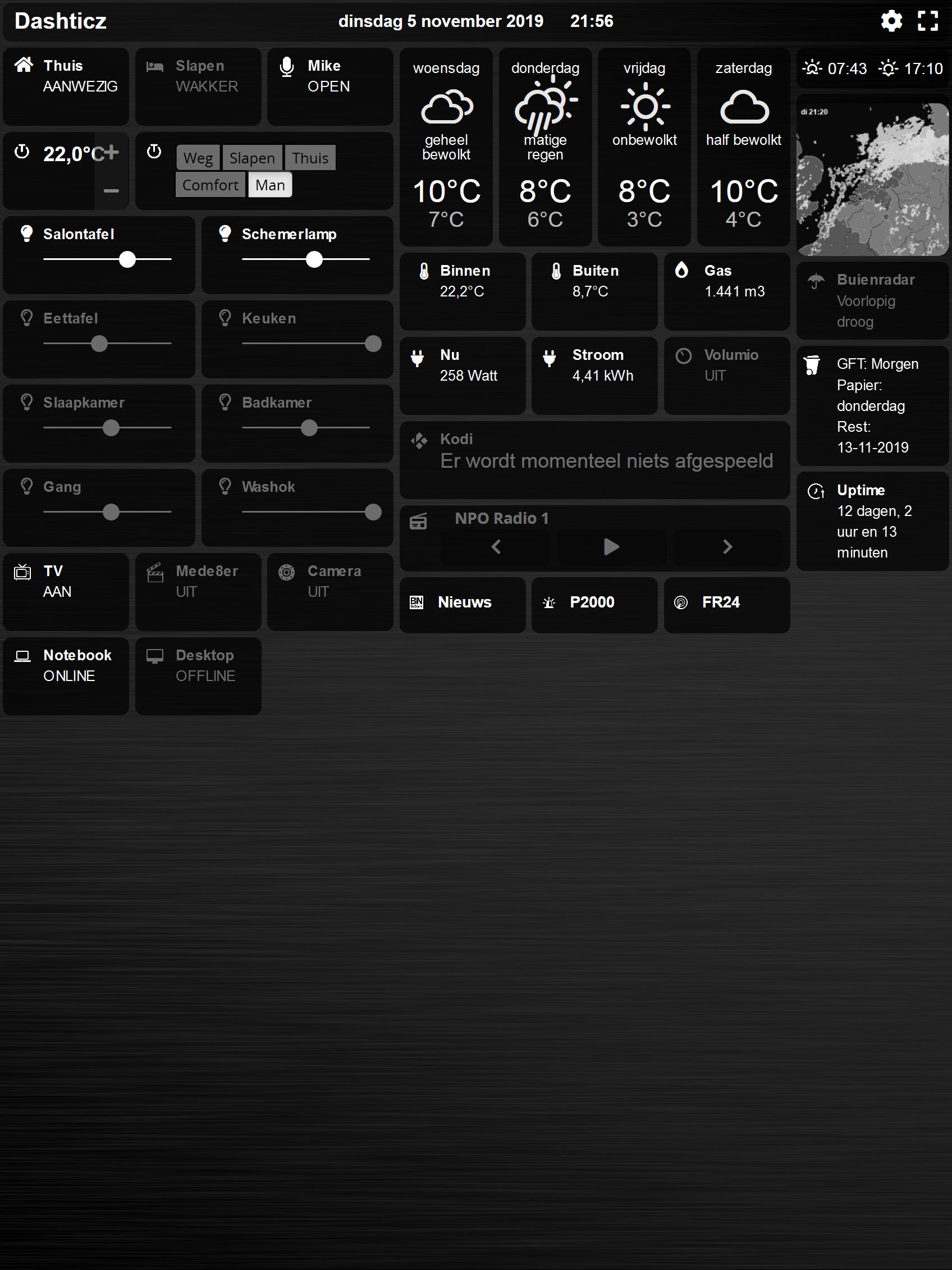

HansieNL
Posts: 969
Post by HansieNL »
My final dashboard :D :D
Blah blah blah

HansieNL wrote: Tuesday 05 November 2019 22:02 My final dashboard :D :D
Nice, now care to share the codes? :)
HansieNL
Posts: 969
Post by HansieNL »
EdwinK wrote: Tuesday 26 November 2019 11:00
Here they are:
CONFIG.js

    confirmation: 1
    //flash: 5000
blocks[149] = {} //Poetsen
blocks[236] = { //Lamp Salontafel
	hide_data: true, width: 6 }
blocks[249] = {} //Homey (alive)
blocks[252] = { //Lamp Badkamer
blocks[258] = {} //Kodi
blocks['274_1'] = {} //Energieverbruik (P1 USB)
    blocks['274_1']['title'] = 'Nu';
    blocks['274_1']['switch'] = true;
blocks['274_2'] = {} //Energie vandaag (P1 USB)
    blocks['274_2']['title'] = 'Stroom';
    blocks['274_2']['switch'] = true;
blocks[276] = {} //Internet (alive)
blocks['320_1'] = { //Gas vandaag (P1 USB)
    title: 'Gas',
    switch: true,
    icon: 'fas fa-burn'
    //image: '../custom/img/gas.png'
blocks[330] = {} //Afvalwijzer (text)
blocks[344] = {} //Open Weather Map (hidden)
blocks[345] = { //Buienradar (text)
    title: 'Buienradar',
    switch: true,
    width: 12,
    image: '../custom/img/umbrella.png'
blocks[346] = {} //RegenData (rain sensor)
blocks[347] = {} //Paraplu (switch)
blocks[350] = { //Notebook PC
    title: 'Notebook',
	textOff: 'OFFLINE',
	textOn: 'ONLINE',
	image: '../custom/img/laptop.png'
	//icon: 'fas fa-laptop'
blocks[351] = { //Desktop PC
    title: 'Desktop',
	textOff: 'OFFLINE',
	textOn: 'ONLINE',
	image: '../custom/img/desktop.png'
	//icon: 'fas fa-desktop'
blocks[352] = { //Mede8er
	/* textOff: 'OFFLINE',
	textOn: 'ONLINE', */
	//imageOff: '../custom/img/toggle_off.png',
	//imageOn: '../custom/img/toggle_on.png'
	image: '../custom/img/clapper_board.png'
blocks[354] = {} //Buitentemperatuur (OWM)
	blocks[354]['switch'] = true;
blocks[391] = { //Lamp Washok
blocks[392] = {} //Flightradar24 (alive)
blocks[400] = { //Schemerlamp
blocks[401] = {} //Dummie
blocks[413] = {} //Kodi System Alive Check
blocks[417] = { //Lamp Gang
blocks[428] = {} //Beweging Keuken
blocks[431] = { //Lamp Keuken
blocks[435] = {} //Camera
	blocks[435]['image'] = '../custom/img/camera.png';
blocks[437] = {} //Binnentemperatuur (Toon)
	blocks[437]['switch'] = true;
	blocks[437]['title'] = 'Binnen';
blocks[438] = { //Toons (Selector Switch for Toon Program State)
    hide_title: true,
    width: 8,
    image: '../custom/img/toon.png'
blocks['441_2'] = {} //Thermostaat (Toon Setpoint)
    //blocks[441]['hide_title'] = true; // NOT AN OPTION
    blocks['441_2']['image'] = '../custom/img/toon.png';
blocks[442] = {} //TV
    blocks[442]['image'] = '../custom/img/tv.png';
blocks[443] = {} //Tuner
blocks[444] = {} //Volumio
    blocks[444]['image'] = 'volumio.png';
    //blocks[444]['image'] = '../custom/img/jukebox.png';
    //blocks[443]['confirmation'] = 1;
blocks[326] = { protected: true, width: 4 } //Placeholder
blocks['v3'] = { //Uptime
    title: 'Uptime',
	image: '../custom/img/uptime.png',
	switch: true,
	width: 12
blocks['longfonds'] = {
    width: 12,
    switch: true,
    icon: '',
    image: '../custom/img/lungs.png',
blocks['news'] = {
    image:'../custom/img/bndestem.png'
blocks['traffic'] = {
	//image:'../custom/img/car.png'
    icon: 'fas fa-car'
blocks['train'] = {
    //image:'../custom/img/train.png'
    icon: 'fas fa-train'
blocks['streamplayer'] = {
    image: '../custom/img/radio.png'
blocks['news_nualg'] = {
    feed: 'https://www.nu.nl/rss/algemeen',
    maxheight: 400,
    title: 'Nu.nl' //optional
    //icon: 'fas fa-icon'
//defining number of columns, their contents en widths
//width can be a number 1 to 12, but total widths of all columns should always be 12
var columns = {}
//--- Topbar ---
columns['bar'] = {}
//--- Screen 1 ---
columns[1] = {}
    columns[1]['blocks'] = [6,7,147,'441_2',438,236,400,124,431,126,252,417,391,442,352,435,350,351]
    columns[1]['width'] = 5;
columns[2] = {}
    columns[2]['blocks'] = ['weather_owm',437,354,'320_1','274_1','274_2',444,258,'streamplayer',buttons.bndestem,buttons.p2000,buttons.fr24,buttons.ipcam,buttons.tvgids]
    columns[2]['width'] = 5;
columns[3] = {}
    columns[3]['blocks'] = ['sunrise',buttons.buienradar,345,'longfonds','garbage','v3']
    columns[3]['width'] = 2;
//--- Screen 2 ---
columns[4] = {}
    columns[4]['blocks'] = ['news',calendars.f1,tvguide.npo,tvguide.other]
    columns[4]['width'] = 5;
columns[5] = {}
    columns[5]['blocks'] = ['traffic',trafficinfo.anwba58,publictransport.ovinfobus,'train',publictransport.ovinfotrains]
    columns[5]['width'] = 5;
columns[6] = {}
    columns[6]['blocks'] = ['stationclock',buttons.homepage,buttons.books,buttons.movies,buttons.music]
    columns[6]['width'] = 2;
columns[7] = {}
    columns[7]['blocks'] = [frames.volumioplayer]
    columns[7]['width'] = 6;
columns[9] = {}
    columns[9]['blocks'] = [frames.homepage]
    columns[9]['width'] = 6;
//--- Standby Screen ---
var columns_standby = {}
columns_standby[1] = {}
    columns_standby[1]['blocks'] = ['clock']
//--- Multiple screens ---
var screens = {}
screens[1] = {}
    screens[1]['background'] = 'bg14.jpg';
screens[2] = {}
    screens[2]['background'] = 'bg14.jpg';
    screens[2]['columns'] = [4,5,6]
screens[3] = {}
    screens[3]['background'] = 'bg14.jpg';
    screens[3]['columns'] = [7]
